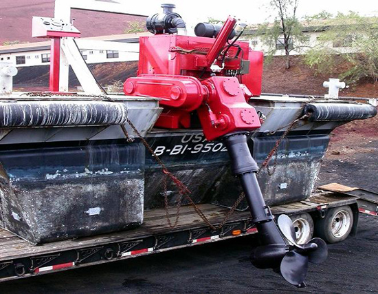

    Would it help to go to a outdrive? Can you run one of them from a shaft with the engine located forward?
    Anybody make a good 600 hp outdrive? Or better yet any one know where there is one in a salvage boat?
  17. NYCAP123
    11,208
    1st, maneuvering a 36' steel Roamer with a single I/O would have your neighbors clearing the marina. 2nd, the connection would be fairly insane if even possible. 3rd, I have doubts if the small prop on a single I/O would even push that boat faster than rowing it. 4th, how good are your welding skills since with the original idea you're talking about closing 6 holes in your bottom, and opening 3 more, plus building an engine box and probably cutting out part of your keel and possibly moving some deck supports. With an I/O you're talking about cutting a hole in your transom, and pushing your motor back till who knows what will happen to your stability. Dumb question, why are you not just rebuilding the existing motors or replacing them with twins? This really sounds like the kind of project that ends up sitting in someone's yard for 20 years unfinished.
