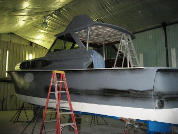

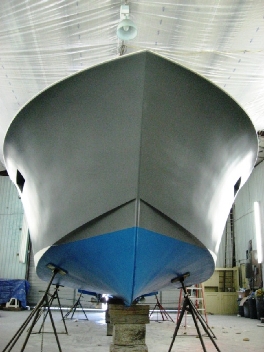

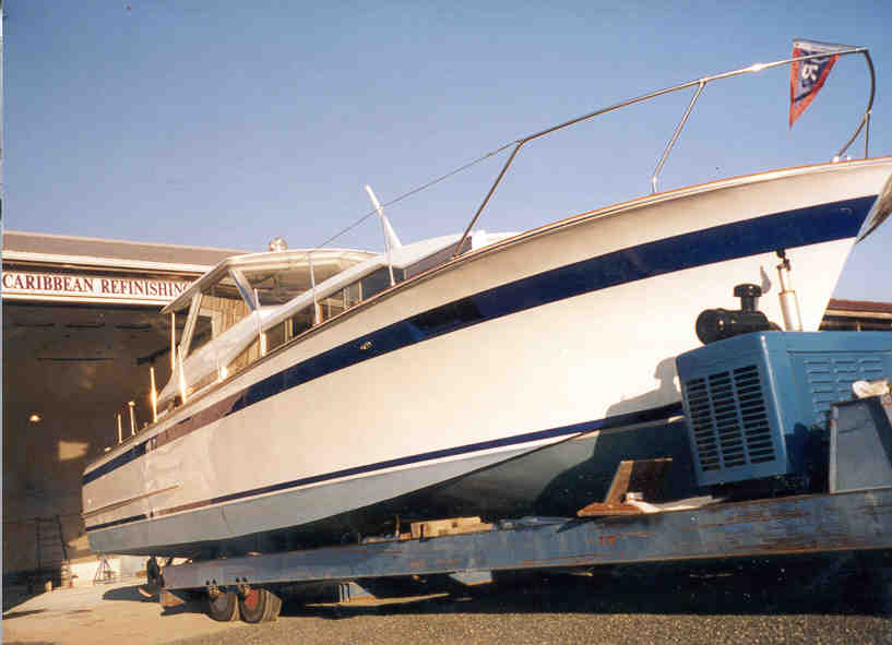

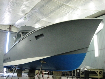

    PS - Added some "example" photoEz from "Adjournment's" latest refit - all because the first repaint did not meet owners standards. :p
