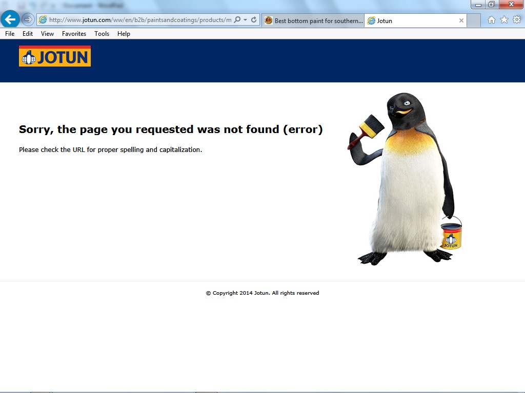

    Kiwi,
    That web page is not working.

    Works for me.

    137
    The whole Jotun site has problems at this time.
