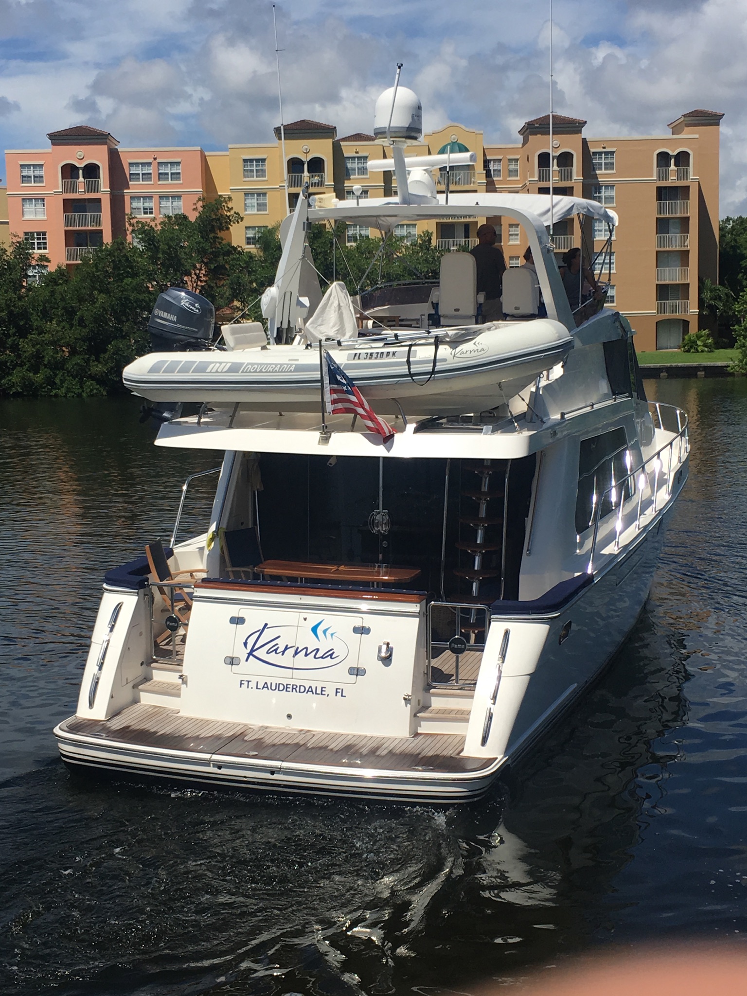

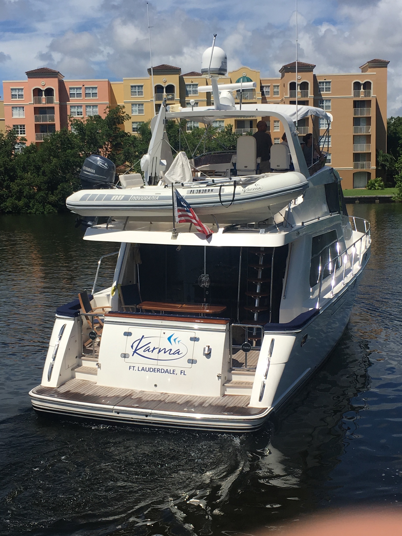

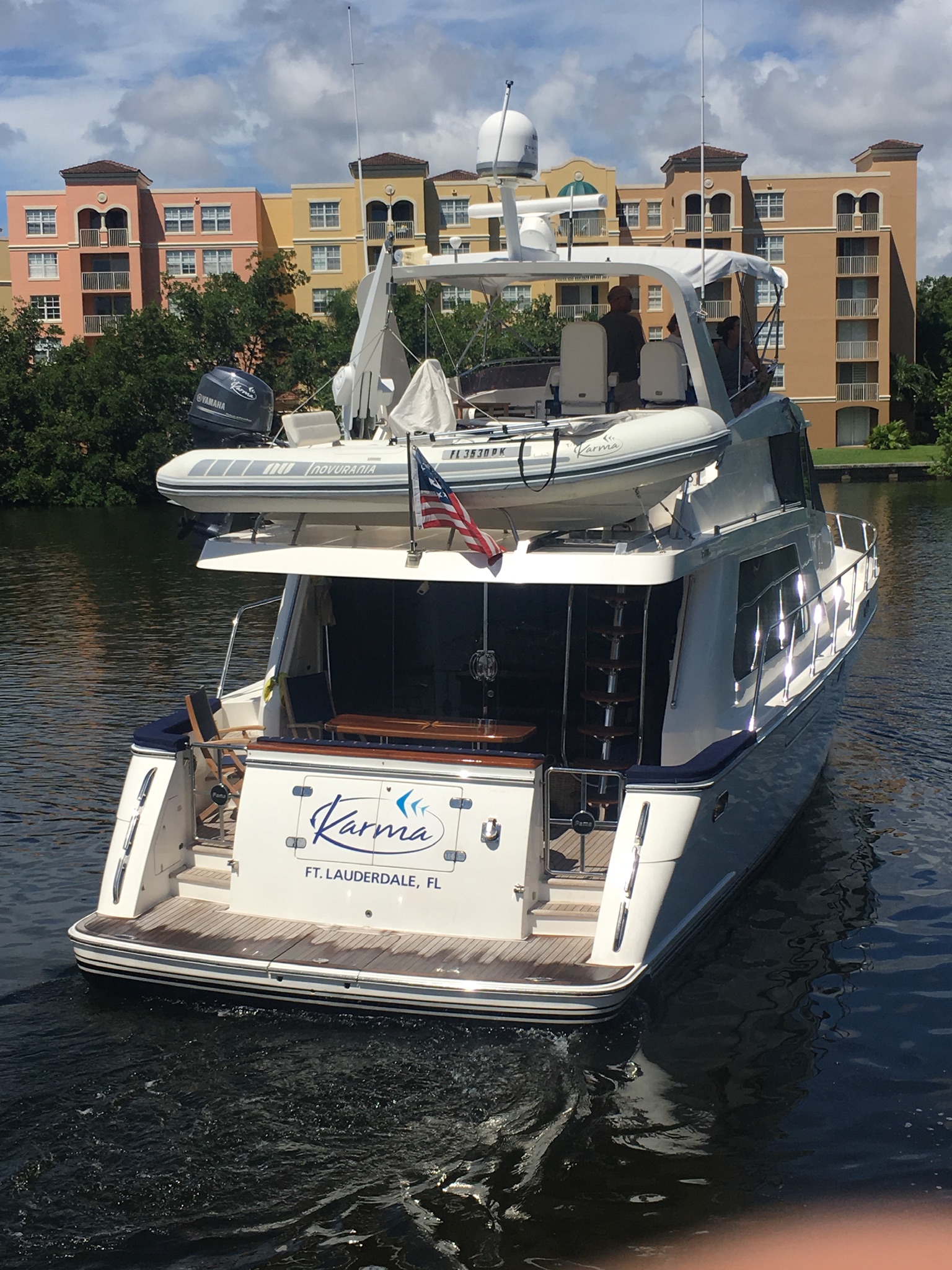

    My setup is close to your sweet spot. After looking for a few years I decided against a trawler and went for the speed of a M/Y. I have a 2007 Pama 54 Flybidge; nice salon, good galley, 2 queens and a bunk room down. 2 heads— and frankly the showers are better than I have at home. Washer and dryer are used constantly. Great grill fridge sink and ice Maker on FB, and a 13’ tender fits up top. Great teak and holly interior. I upgraded the bimini and installed a Yacht Controller (to save my marriage)
    Twin Volvo D-9s will cruise 20kts @35 GPH, but hull
    Speed closer to 5gph. we have a water maker and big lazarette. Engine room access is Good. Holds 700 Gals of diesel. I’ve taken it to Abacos, Chubb, Bimini, Key West and back up west coast, Naples and across Ocochobee Waterway. I wish I had stabilizers, but don’t think I want to spend the $$- even though i would love them and it would help me sell in future.
    It’s kind of like a how a Hyundai Genesis surprises you on how nice it is. Look at lots of boats, find a good buyers agent, and listen to the wise counsel of these gentlemen
