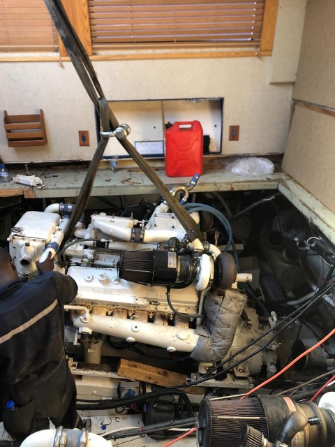

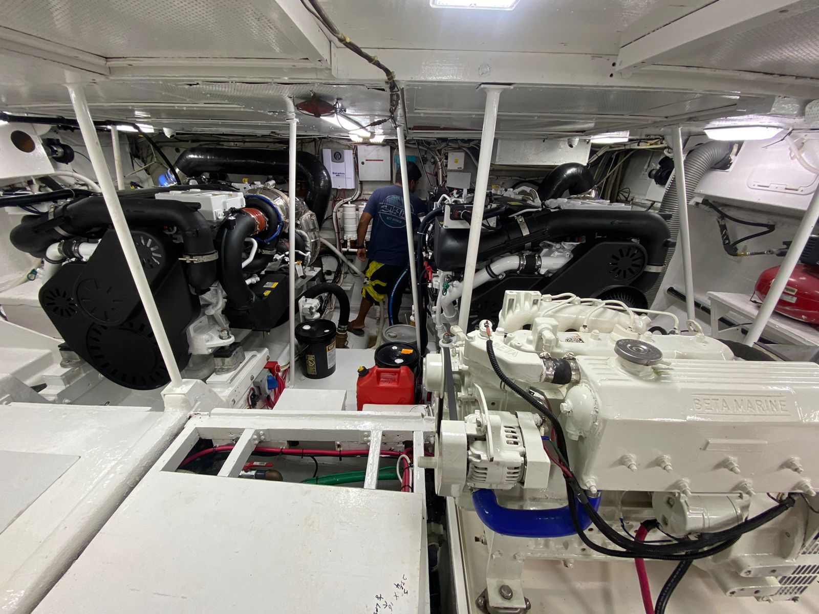

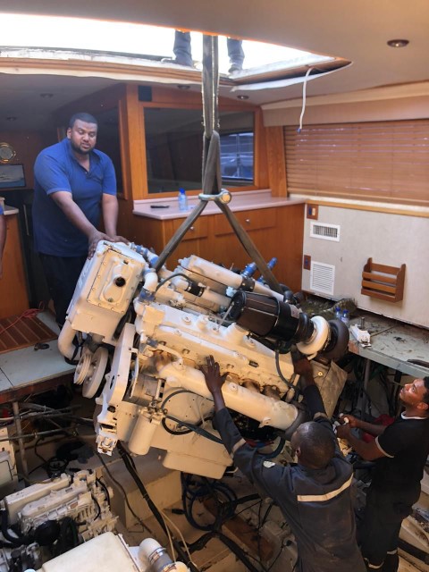

  2. Trinimax
    Trinimax Senior Member
    Jan 18, 2010
    237

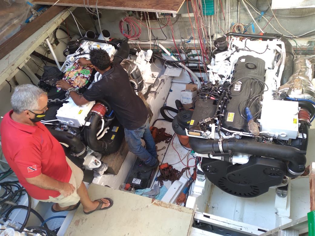

    Here are the cats installed
      147.8 KB
      575
      286 KB
      576

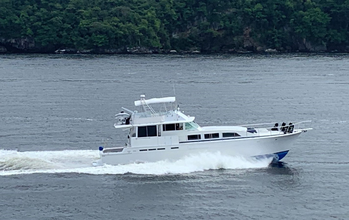

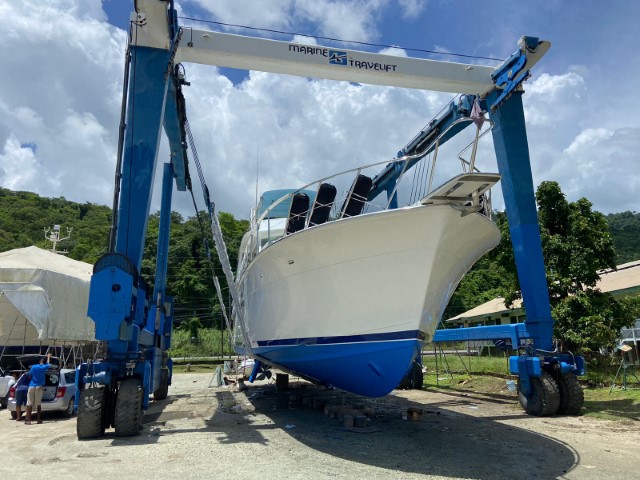

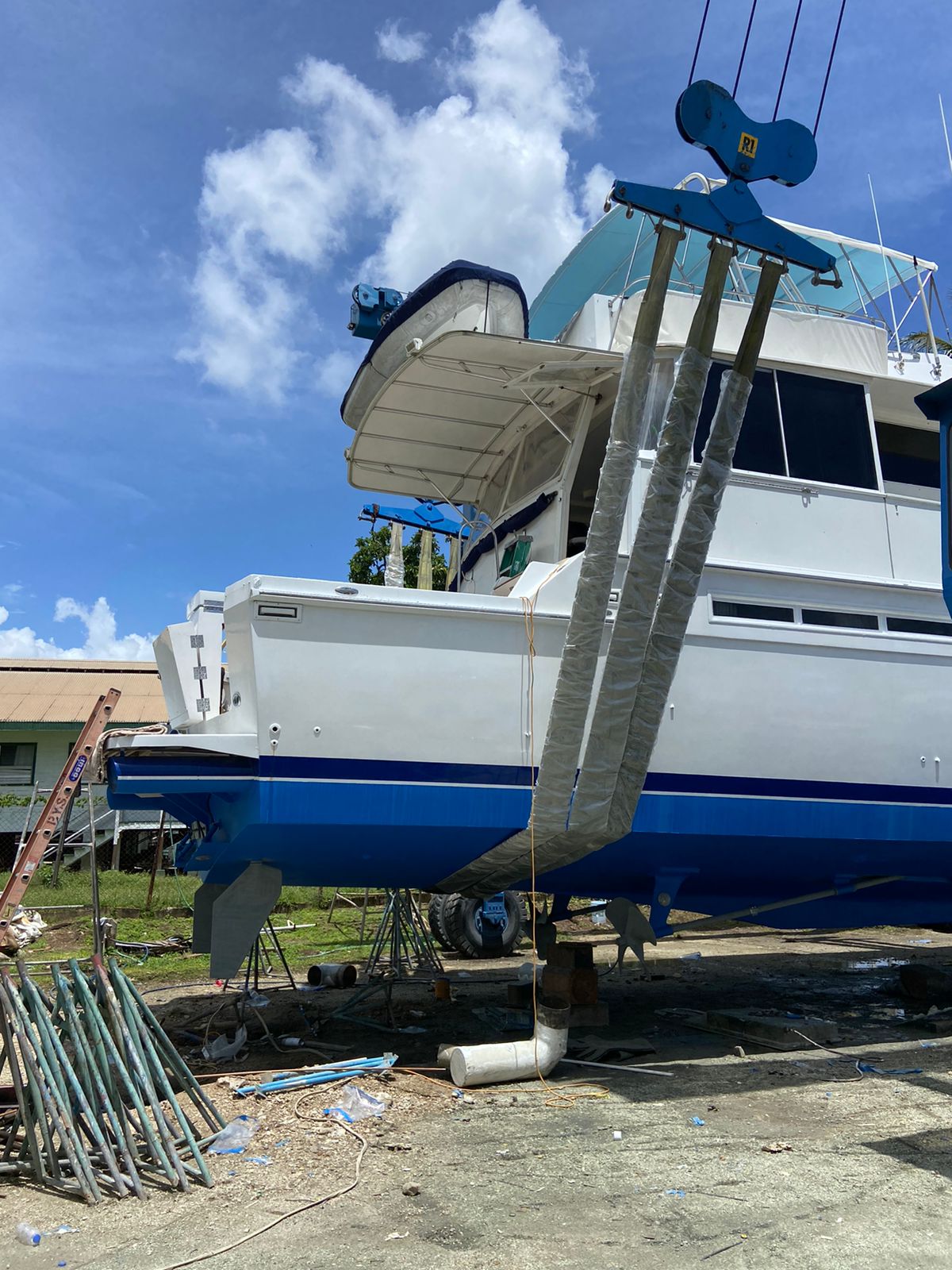

  3. Trinimax
    Jan 18, 2010
    237
    here she is launching and at speed
  4. Capt Ralph
    12,647
    I'll be studying these pictures for a long time to come.
    What clutch was used? I can see it had a down angle.
    Big ole coach roof hatch works darn good.
    Is this the boat that had 3412s originally planned?
    Send in more pictures. Of the extension also please.
    Thx
    Ralph

  11. Capt Ralph
    12,647
    One design item I question, moving the rudders back and not the props.
    You will get no wash on the rudders and poor slow speed operation. I used to run a Roamer house boat with an extension, just the rudders moved back. Ended up upgrading to large stablizer fins for rudders. Still throttles and clutches needed in slow speed areas. The owner may consider moving back to the original locations.

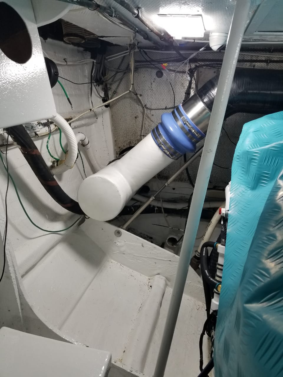

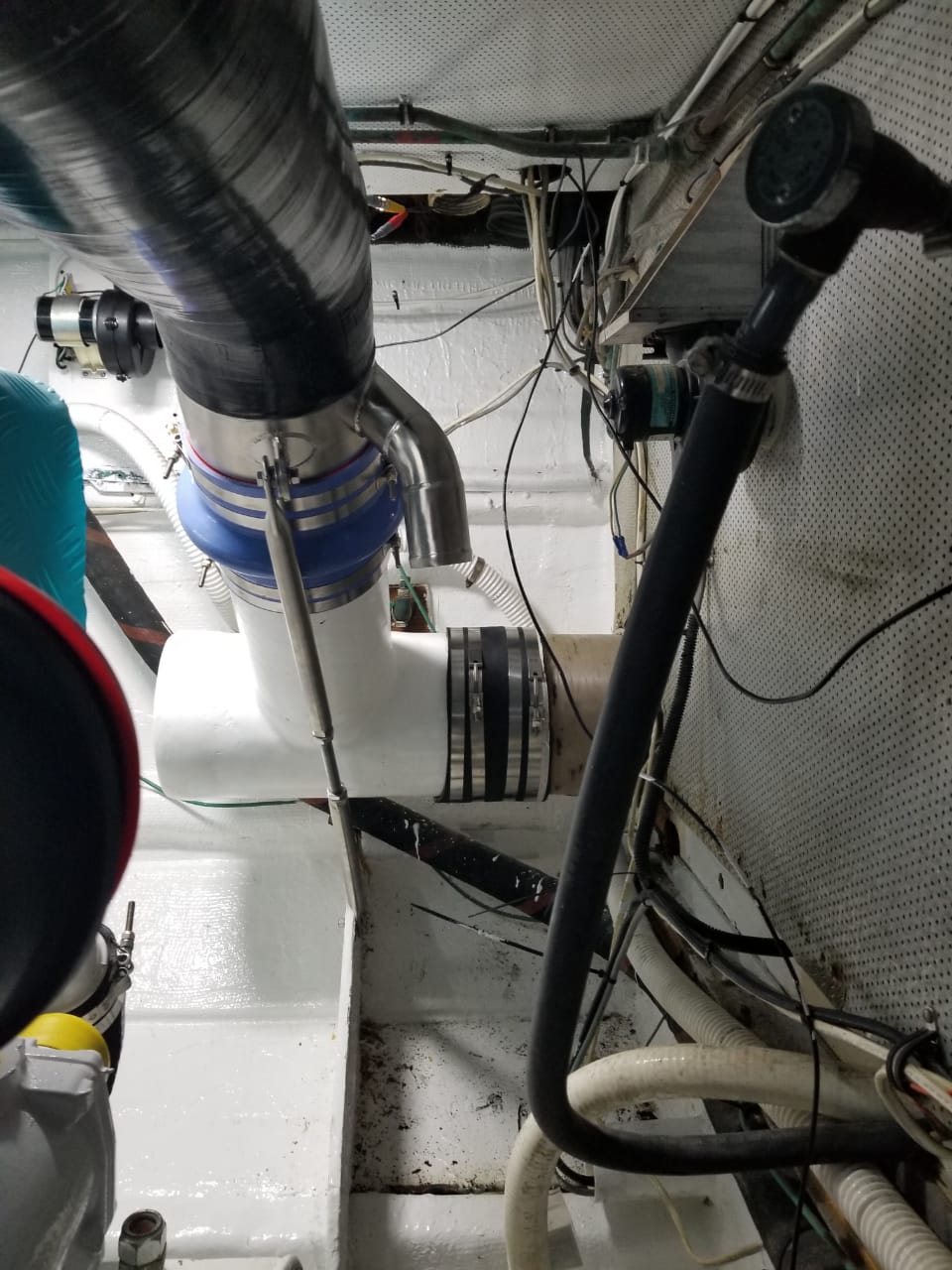

  14. Trinimax
    Jan 18, 2010
    237
    Thanks fellas glad you like the pics. in answer to some of your questions.
    @Capt Ralph
    1. the new gears are ZF 1.97:1 with a 10 degree down angle, where the original gears were straight, so the stringers up forward had to be cut down a bit. this worked well as there is a good bit of headroom above the front of the engine.
    2. The owner bought this boat about 15 years ago with the extension. so fortunately that wasnt one of his upgrades. The rudders were also moved aft by the previous owner. Funny enough there is another 70 ft stretched 58 bert in Trinidad and this had the rudders in the original location, and the low speed steering wasn't very good, and the owner moved the rudders aft. So far the steering is good at displacement and planning speeds, and the bow thruster helps for close quarters maneuvering.
    @motoryachtlover
    there is a boat called the Sirena 64 that is similar size and weight as this bert and she has the 1000 hp versions of the C12.9 cats and the performance numbers are similar. This 58/68 bert has only 15 degrees of transom deadrise, so she is not as deep a V as the other berts

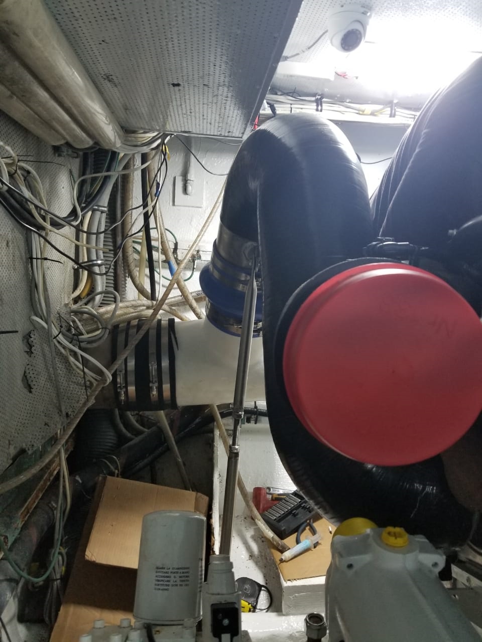

    I have uploaded some pic of the early part of the installation of the custom D angelo exhaust risers. I would have to say that they were really helpful. they sent us a template form with the required measurements to take. Fortunately I took accurate measurements, and the completed product fit perfectly.
    I will try get you all some more pics of the other upgrades carried out on this boat

  15. cleanslate
    cleanslate Senior Member
    May 29, 2018
    1,648
    Cherry Hill, NJ
    Looks good. I do not know, so I'm asking, That white exhaust elbow looks the same on the out side as on the inside? Or does it have a turning vane or defection point in it? Or does it just dump into the '' Tee''?
    How does it work?
  16. motoryachtlover
    motoryachtlover Senior Member
    Jan 29, 2007
    645
    smithfield, VA
    I think it is a T to allow room to keep water from surging up the exhaust and into the engine.
  17. DOCKMASTER
    DOCKMASTER Senior Member
    Feb 26, 2012
    1,396
    Ketchikan, Alaska
    Correct. They are called Surge Tee's. I have the same from DeAngelo as I went with them for my exhaust for my Repower.
