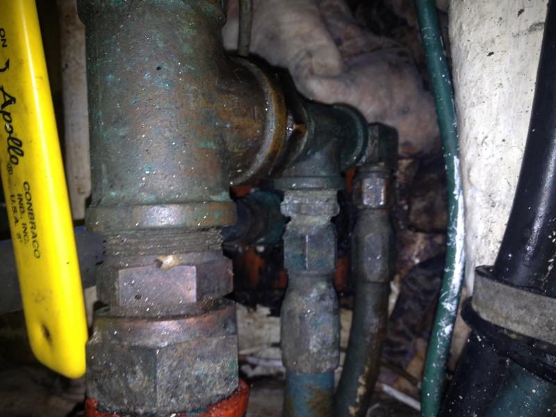

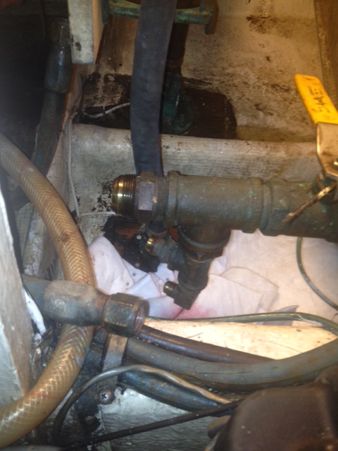

    I uploaded a picture that shows a valve connection. The fat pipe connects the two forward tanks together. Then the next connection goes to the port main and the bottom feeds the Genny. This valve is at the bottom of the tank. The front tanks when 1/2 full or more will prime all the filters because of gravity of course.
    I never have my main's clog, only the Genny because its the low guy. Not sure if Bertram did this on purpose or not.
    I was thinking of putting another fitting with a valve so that when I do get a clog, I open it, get the "Worm" out and go on my merry way.

    Why not re-plumb that and put a trap at the bottom? It looks like some of the particles would drop to the bottom when your mains are running and plug up that hard 90 degree fitting. The generator fitting is basically a trap for the mains. At a minimum you could change to a full flow elbow. Long term I'd probably add a tap for a small pump/fuel filter to the bottom of that stack and polish the fuel myself. That and a little mechanical timer. That would keep the generator line from getting clogged.

    Sorry about the picture it needs to rotate cw 90 degrees.
    Full Flow Elbow would leave the Genny Line out no?
    I was thinking more of the latter part of your statement. Nice idea to add the tap for a fuel polishing pump with filter.
    How about replace the Genny 90 with a T and adding one more level of Trap. Then tap the trap with a fuel polishing pump and filter.
    The moment that Genny starts hicup'n, turn on the Fuel polish pump and suck out the worm!

    I assumed the image needed to be rotated. A full flow elbow would just replace the 90 degree fitting that is there. And it would probably keep the "worm" from forming by allowing whatever did collect there to be pulled through the filter on the generator. The "worm" is probably also dirt that collects there as the fuel sloshes from tank to tank through the crossover pipe.
    Best solution would be the pump and filter though. If possible set it up to return to the same tank(s) OR transfer to another tank. That would allow you to empty those forward tanks completely and remove any floating debris.

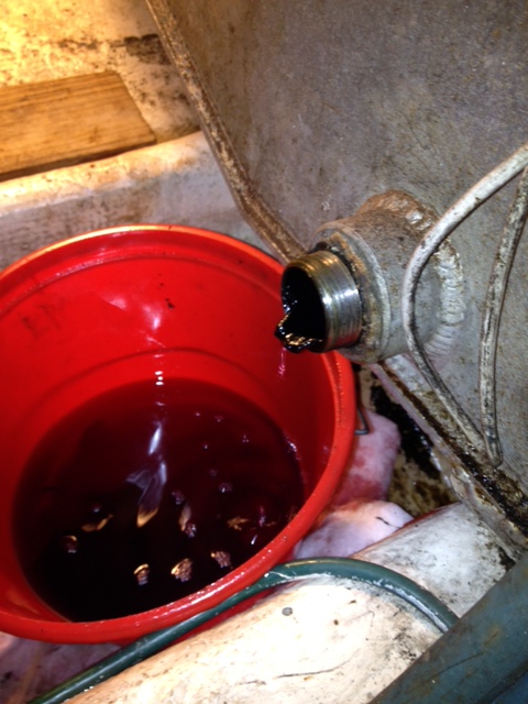

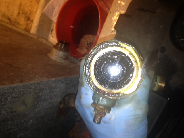

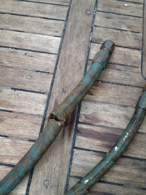

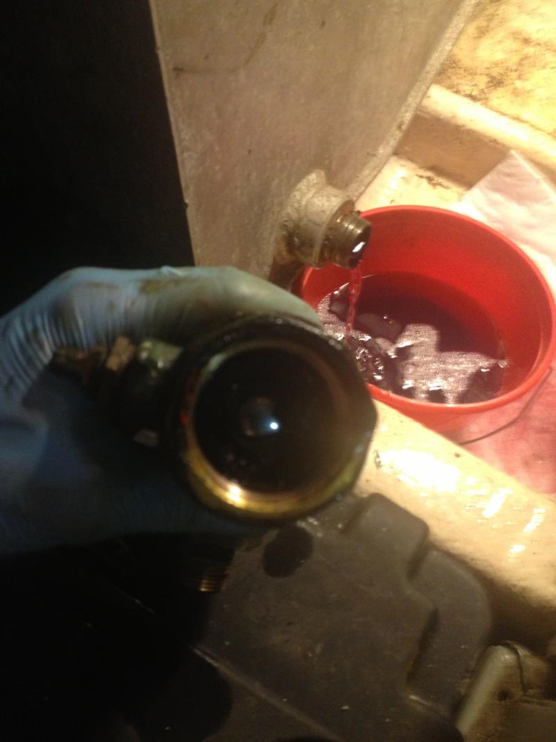

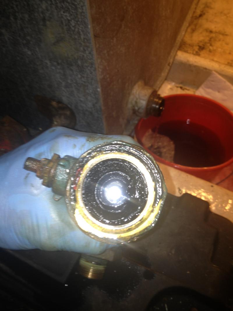

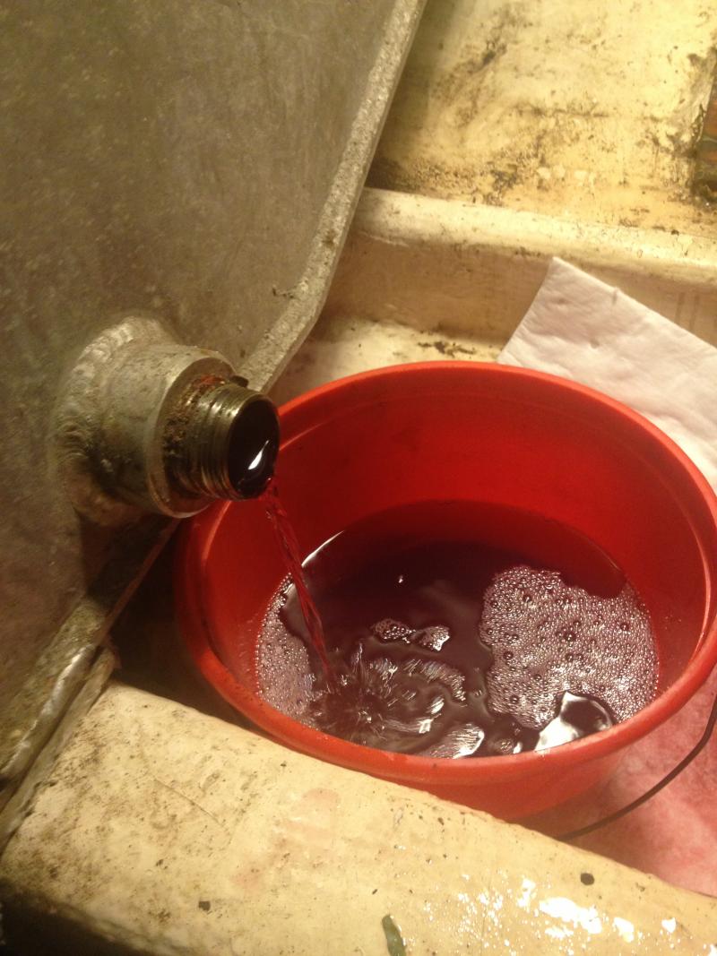

    Well after 1 week of 25-30 knots winds I decided not to go to the Bahamas and do my oil and filter changes and also the cleaning of the front two tanks.
    Look at the picture of the weather it was tough decision.
    I pumped all the fuel to the back tank using a commercial fuel polishing system that a friend of mine lent me. Check filter for water and there was none. There was some debri.. black like gunk, but it was kind of hard and brittle as well.
    Then I removed plumbing from each tank. The Port had a lot more of the black gunk stuff than the starboard. I removed as much fuel as I could but there is still like a gallon or so left. Im think of using my shop vac with a special pick up tube, with a 90 degree or 45 degree pick. Im thinking this is where the bulk of gunk lies. Looking into that hole, I can see the black stuff.
    Hopefully, will get it all out this week. Any thoughts on how to get it all out, pls chime in.
    Also, I was told to use Rector Seal #4 on the pipe threads of the fuel line. Does that seem right?
    Here are some pics...
