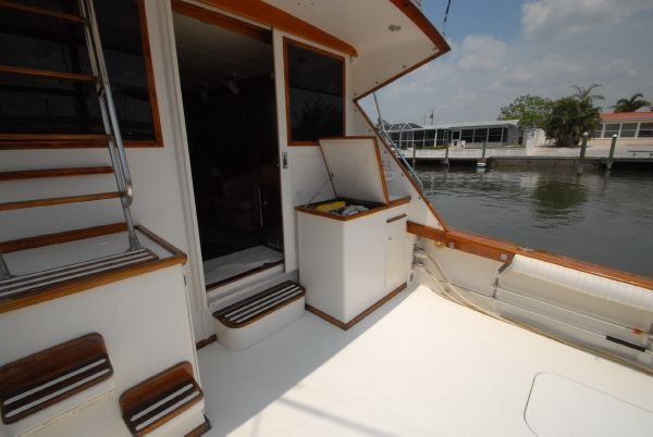

    I want to put a bait freezer in my cockpit. Currently there is an old washing machine in the starboard lockers where I would like the freezer.
    The dimensions are:
    19 1/2" deep (fore-aft)
    21 1/4" athwartships
    33 1/2" deep
    Problem is, I am having a tough time finding a commercially available chest freezer that will fit, even with the 3.5 Cu Ft models.
    Any ideas?
    I am attaching an old pic (from YW listing) of that starboard side locker.
    Thanks!

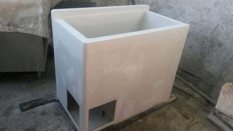

  7. Gambetica
    Gambetica Member
    Aug 3, 2013
    45
    Venezuela
    Hello! We made this one, Hope it helps...

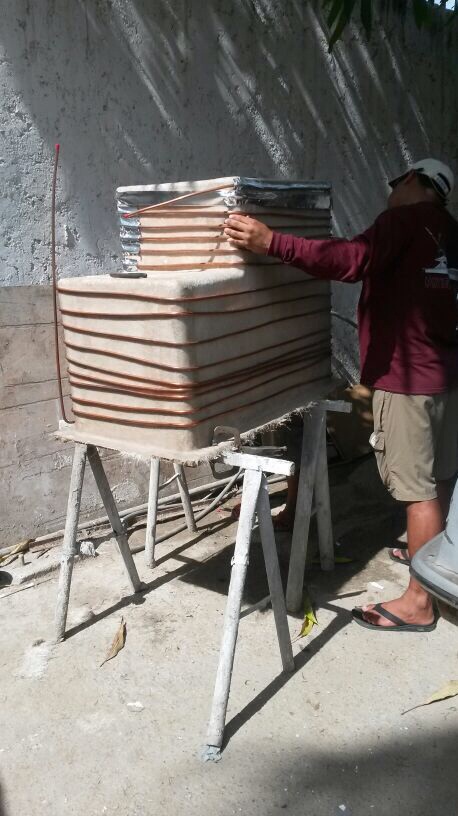

  8. Gambetica
    Gambetica Member
    Aug 3, 2013
    45
    Venezuela
    Pic 2...
  9. Berean
    Berean Senior Member
    Aug 26, 2007
    303
    Sarasota FL
    Very nice!
