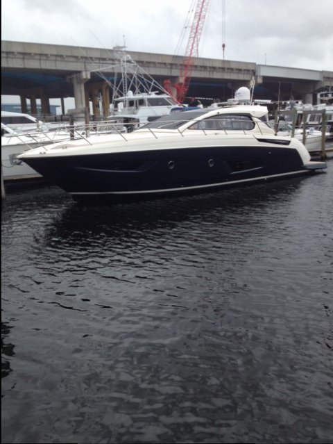

    The hull is dry and no pounding, landings are soft and I've already been out in bigger seas than the SR. QSC 600 really pull the boat jumps on plane and full used is not much more than the qsc 500 I had. Now the problems all the portholes leak and the hot water heater keeps tripping the breakers. Oh well it's a boat! IMG_0451.JPG
