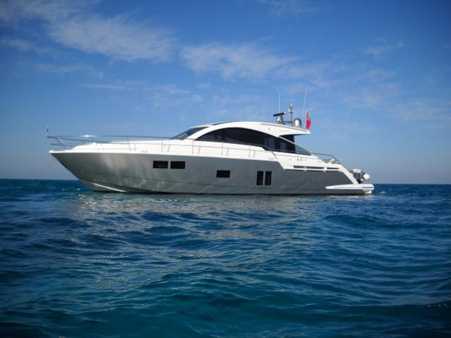

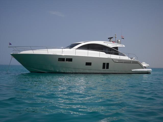

    These are the two boats I have painted with the Alexseal system:

    Great looking boats.....his and hers? who painted them?

    Thanks :).......I sent you a PM with the details of the company which did the paint work.
