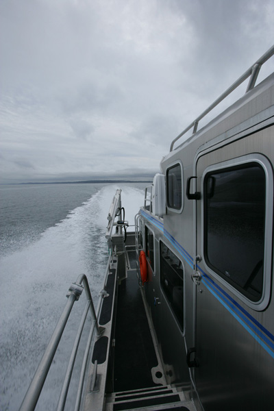

    We were doing about 25 knots here, on a Armstrong 35'. I can only imagine a 45 knot rooster!
  7. Thomas Bliss
    Thomas Bliss New Member
    Jan 18, 2008
    15
    Gig Harbor, WA
    The engines are Cummins 6CT8.3 450 h0 each. Actuall 430 US hp @ 2600 rpm.
    The transmissions are 5075A Twin Disk, one with trolling valve.
    The drive systems are ASD 10 Arneson(now owned by Twin Disk).
    There is about a 10.5 inch driveline between the Transmission and the Drive
    shaft.
