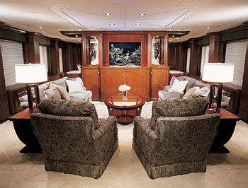

    Here is a copy of a pic of the Aquarium that "foundrycourt" mentioned on MY Bart Roberts. It is used as a room divider between the Grand Salon and the Dining Room.
    Old One
