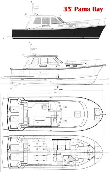

    I own a 36' flybridge cruiser built by Pama Yachts in Hong Kong (model is a Pama Bay 35 if you want to check their website). As far as I can tell, it is the only one of this model in the US. My wife and I love the boat and have used it as our summer home. However, we just had our second child and will likely be using it more as a day boat then for cruising the next few years. Our only complaint about the boat is that the aft cockpit is small (about 5'x10'), and the aft cockpit is really what makes a great day boat in our opinion. I am looking into extending the hull by 3.5 to 4' to create a larger aft cockpit space for a setee and table.
    Does anyone have experience going through this? I normally wouldn't look to make this type of modification to a boat out of concern for resale, but given this boat is 'uniqe' already and we don't see anything in the market that gets us what we want without spending 300-400k more, I am considering it. Just curious if anyone can share what their costs were to do an extension, any issues that came up during the process and how you've liked living with the result.

    Have you asked the yard for any drawings so that a surveyor or naval architect can check to see if it is a viable option?

    We lengthened a 45' hatters double cabin hull 6'. If the aft section of the hull is straight you can build mold off the existing hull or build them with plywood and masonite. I wouldn't do it without moving the rudders and running gear back.

    A rule of thumb for Naval Architects has been 10% of the waterline line for hull extensions would not require shifting rudders, shafts, etc. There have been several hull extensions that have pushed beyond that level (without changing running gear) with mixed results. I know of some 42' Uniflites/Chris Crafts that were extended to 48' without modifying the running gear and were fairly successful. Seen it done on some Hatteras and Californian Double Cabin Motoryachts as well.
    It is not something overly complex for a competent boatyard, and you will usually offset the gain in bouyancy with an additional FW tank. Scarf into the existing stringers (greater than a 12:1 ratio) keep the lower existing transom as a flange to connect to, and through bolt your FRP bonding angle to it for good measure.
    I think you are within reasonable limits at 3.5', although you could consider larger rudders which may require an upgrade to the steering system, autopilot and the rudder foundation.

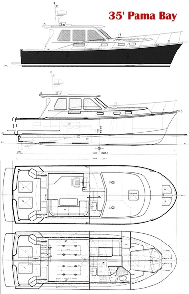

    If it's only a couple of feet, you might be able to extend the vessel without extending the underwater part of the hull, because doing that, your increasing the buoyancy, which will change the Centre of Buoyancy and Centre of Gravity, and may upset the performance (I doubt much though). Basically, a few more things the Nav Arch has to worry about.
    I've attached a little concept I did on paint, it's just a thought, but you can extend the above water portion of the hull, material would/could be a foam cored composite to keep the weight to a minimum. Plus, you wouldn't know it's an extension when the vessel is in the water. Cheers

    Hard to say what a yard would charge today, but there should be some one hungry for work. I would hope you could get it done for around $60K - $75K, but that is just a swag on my part.......
    If your boat currently runs better with a some Trim Tab, the increase in waterline length may even provide a benefit in a (little) more speed.

    With regards to rudder size, a simple but effective rule of thumb for Naval Architects is to estimate the underwater profile area, and take a percentage (1% - 3%) depending on what type of vessel it is - planing, semi-planing, or displacement.
    Take a scaled drawing, estimate the average length of the underwater profile, then take the average depth of the fairbody (centerline of the hull, no keel) and you will get the underwater profile area. Now take a percentage of that area, 2% should be a good average, and divide by the number of rudders. This will give you an idea of your individual rudder area and whether or not if it is large for your size of vessel. Of course, you would have to recalculate if you are making a hull extension.

    Thanks, Far. I appreciate your thoughts. I contemplated this for a bit, but haven't really pursued it. My only concern is that a 3ft platform will put the swim platform well in the wake of the boat. I carry a 10ft RIB on my swim platform and it already takes a bit of wake when getting up and off plane.

    The challenge for an extension on a boat of this size will be how to compensate for the additional bouyancy after the structure is added. You probably won't have an option nor would want to go to the expense of moving your existing fuel tanks, so I could see the following options:
    To estimate (ballpark figure only) the added bouyancy: 3.5' length of extension x 10' average chine beam x 1.5' average depth (acounting for some deadrise) across the extension would give you about 52.5 cubic feet of volume, with saltwater at 64 lbs/cubic feet you have added approximately 3,360 lbs of displacement.
    The square footage for fiberglass could be estimated as: 2 sides (port & stbd) x 3.5' long x 4' tall from chine to gunwale = 28 sf. Transom would be about 4.5' x 11' across = 49.5 sf, hull bottom (port & stbd) would be about 2 x 3.5' x x 5.5' along the deadrise = 38.5 sf, cockpit about 3.5' x 11' = 38.5 sf, and cockpit coaming about 2 x 3.5' x 1' + 11' x 1' = 18 sf. Rough Total is about 173 sf, add a margin of 10% and yo get about 190 sf of frp lay-up without stringers, bonds, overlaps, etc. At about 10 lbs/sf, you are at 1,900 lbs and need to make up about 1300 pounds in equipment, tanks or whatever you choose to neutralize the effects of the added bouyancy of the extension. A litlle more weight would even get you to be trimmed down by the stern, desirable for a planing craft.
    Added Fuel Tank - not my first choice, as you probably have an aft fuel tank, and if you have to use the additional fuel tank which is further aft, your vessel will be trimmed by the bow and this condition will only increase, definetely making the boat squirelly in a following sea and increasing the pucker factor running an inlet.
    Added FW Tank - better overall use for trim if the main FW tank is forward, but will have some trim issues as well. Maybe better to use it as an emergency back up FW Tank or FW Washdown. Water may get stagnant due to lack of use.
    Equipment - add something heavy and usefull, such as an Inverter Bank tied to solar panels on the hardtop (if you have one). Would not affect the static or running trim and would be easier to deal with. Obviuosly, you could add other pieces of fixed equipment, within reason of physics and pocket book - not sure which comes first :D
