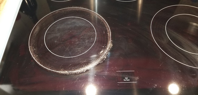

    The glossy glass top you will never keep new clean. If you can, stay with a flat or mate finish.

    Ralph.. induction tops don't mark like radiant because the top doesn't get hot like a radiant.
  5. Capt Ralph
    13,436
    After a while, boil overs, cooking grunge, hot splatters start leaving their trails on the smooth glass surface.
    "Barkeepers Friend" seems to be a good cleaner. But if you are in luv with that glass smooth surface and cook like a mad man, keeping that clean glass gloss can be a chore.
    Currently, our cook surface is a mess after dinner. Josie will shoot me if I try to get a picture rite now.
    Click, Click in the back ground.
  6. MBevins
    MBevins Senior Member
    May 23, 2008
    1,225
    Windsor On. Canada
    Not to argue but we have 3 of them and don't have that issue.
  7. Capt Ralph
    13,436
    Outstanding. You are probably a better and neater cook than us. :D
    It's a Samsung.
    However, we do luv it still.
  8. Capt J
    14,530
    Get that cooktop cream cleaner, Weimans, it works amazing at keeping them clean. Baked on stuff that's really tough comes off with a good razor blade.......... Yes, Induction is amazing in it's speed.

  15. DOCKMASTER
    DOCKMASTER Senior Member
    Feb 26, 2012
    1,497
    Ketchikan, Alaska
