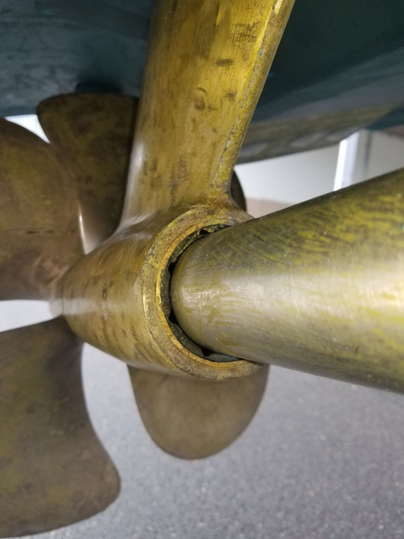

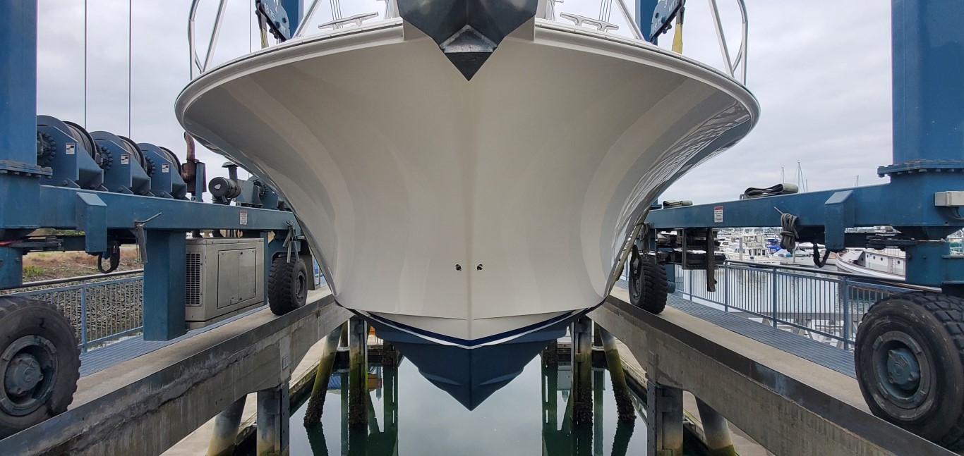

    When I bought My Cabo there was a fresh coating was on all the underwater metals. It has performed well and after 4 years I would like to apply a fresh coat. I just don't know what it is. I can see brush strokes on shafts that to me implies it is not very thick like what I would expect from prop speed. Any help would be appreciated.

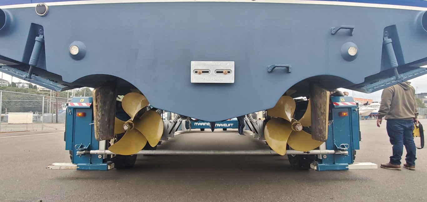

    The only time it bothers me is when I have touched up my bottom paint and applied new zincs then go to take a pic. It looks half azz so to speak as the rudders and props are clean but look like they are half worn. Now that I know what it is I will atleast know my options when I haul the boat in a couple weeks.

    Unless in flesh it's much better than it appears in the photo, I'd rather replace the shaft bearing first.

    I have no problem replacing cutlass bearings if needed. I have looked at that each of the last 3 haul outs but am not sure what my sign for replacement would be? If they look worn to you pro's then I will jump on it. Power is smooth and when I did shaft seals I checked for play and there was none.

    Well it does look somewhat worn to me (though I've seen much worse).
    Do you know how old they are, and how many hours they clocked?
    Anyhow, as I said, that can only be judged in flesh.

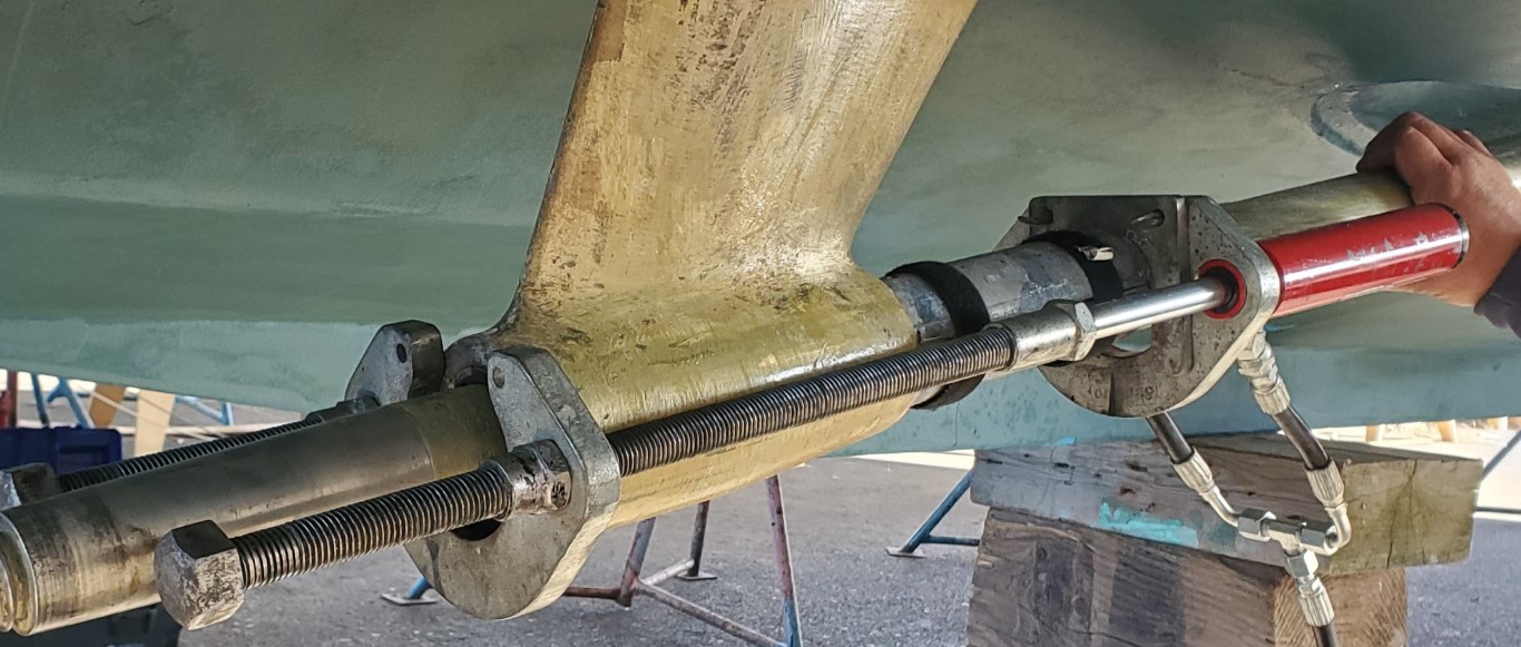

    Thanks for the input guys. Hauled out on Monday and went back into the water today. Replaced the cutlass bearings and condition was not horrible but upon removal you could see that the Port side (shown in pic above) was starting to lose one chunk of rubber and it was a good time to just replace them both. With the hydraulic tool it was an easy job. Had never seen that done before. Pulled the props and had them scanned. Stbd was perfect but he found on blade on Port with minor issue. Fixed that and bead blasted prior to prop speed application. Removed a transducer and sent to Airmar for warranty replacement. Did one coat of bottom paint and zincs along with full hand wax of the hull. Received the new transducer via overnight and got that installed. Had some thru hulls that the paint was starting to flake so for now I removed the remaining paint and cleaned them up while Transducer sealant was curing. Back in house and all good. Thanks guys.

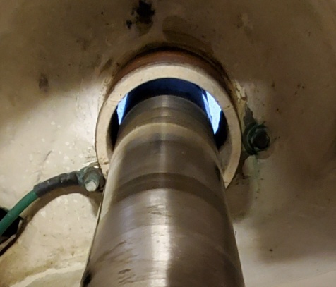

    I replaced shaft seals a year and a half ago. Pulling the shafts is not easy as the coupler connection takes some time to disconnect.

    I wasn't thinking of the seals, but of the bearings (if any).
    Seals aside, in many boats there are ALSO bearings, similar to those which you replaced on the bracket, on the wet side of the shaft seals, where the shafts go through the hull.
    But as I said, I'm not familiar with Cabo boats, so I don't know if that's their setup or not.

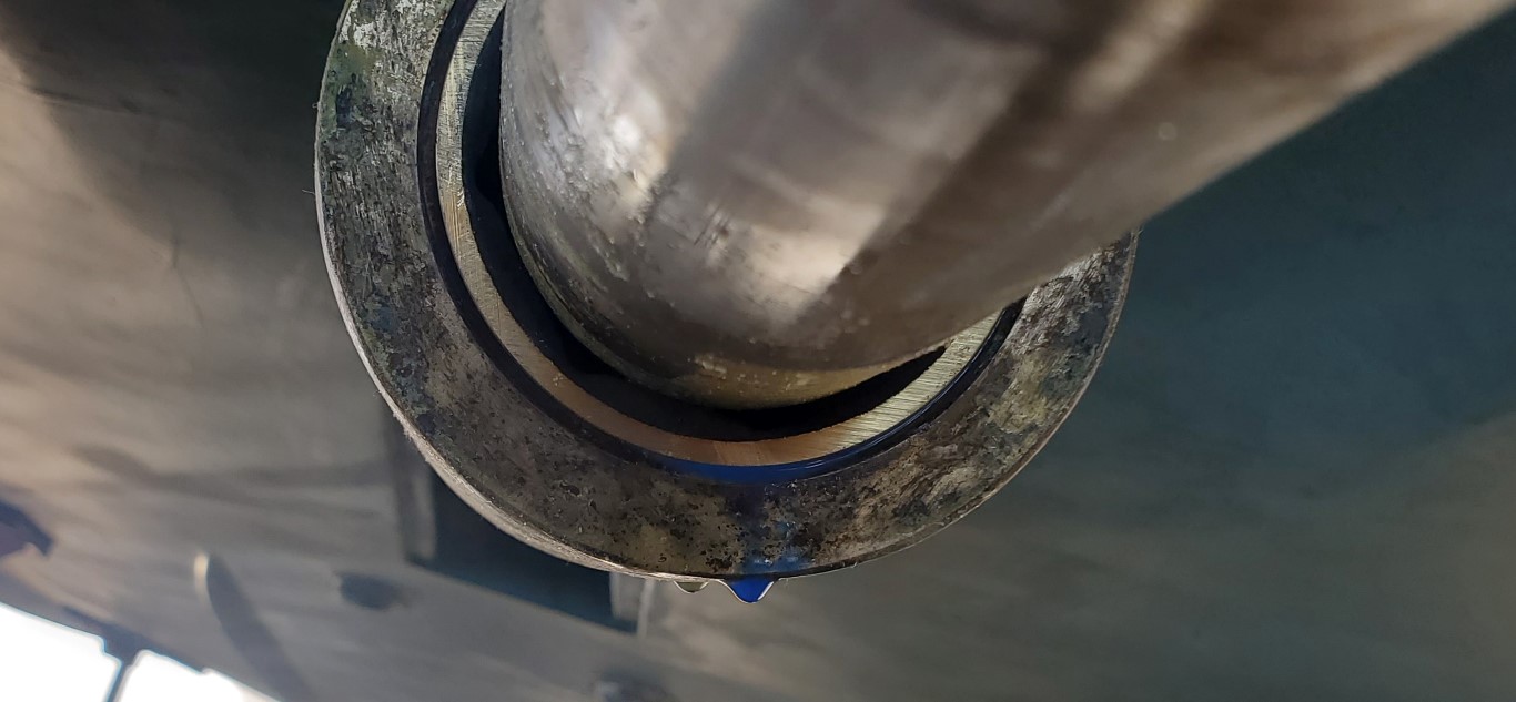

    Is that how the running gear looked when you came out of the water after a bit? That clean? Or was there sea growth on them?
  19. Capt Ralph
    13,443
    Shaft a bit low in the pic?

    This was when slid back doing shaft seals a year and a half ago. Was just showing that there was no bearing as discussed above.
