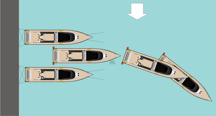

    Driving slow will give you a cheaper damage report..;) Especially if you are not used to the boat. Keeping big balloon fenders in the aft corners is also an insurance. With a bow thruster it should not create a problem and if you practise a little outside the port so you know how she behaves in different angles and wind directions you will feel safer.
    What I do is to go down a little and back up towards the wind with the transom pointing to the gap and then use the bow thruster to get a straight line in. Then you donĀ“t "lose" the bow in a gust. Try it outside and see if you like it.
    I made an illustration, a little exaggerated, and with some practise you can do this without a bow thruster too as you will get the bow in a natural "swing"...
