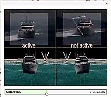

    Thanks for the link. I am not totally convinced. Take a look at the video why would they have the boat with the non active running more perpendicular to the passing boats wake. Very obvious that it would exagerate the roll effect. To boot they are over rotating the reference angle on the screen to exagerate the roll. I don't doubt that it has some improved effect but there is no doubt they are exagerating a bit. At least in this video. Maybe they didn't have to but they felt for marketing purposes they needed to "enhance" things a little. I am sure there is merit to this however I think it will take a bit more to convince me.
  9. Yachtguy
    Yachtguy New Member
    Jan 6, 2006
    22
    BC
    The over exagerated screen reference is just before half way through the video. I would post a screen clip copy of it here but that may be a copywright issue they may not appreciate.

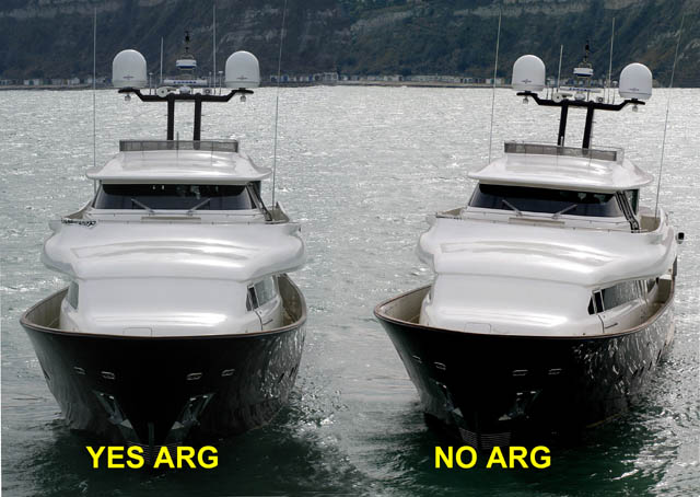

    Which prompted me to take a second look at the image supplied in the link above, seen here...
    [​IMG]
    It wouldn't be difficult to create this imbalance if the boat on the right was swinging around the transom of the boat on the left, pulled a fast stop, add a little port bow thruster, reverse a gear and... voila! One could also question "why" the boat on the right has been presented with an instability, when the surrounding conditions appears to be calm.
    Not insinuating this was done, by any means. Just speculating on how this could be staged. That being said, Mitsubishi is a reputable company and I'd be hard pressed to believe they would gear up for production if the unit didn't offer some benefit. To what degree... remains a question.
    Sorry to refer to these Custom Lines as boats. Just using them for reference.

    OK I see we are allowed to use pictures from others. Attached is a snap shot from the Movie link refered to which really shows the exageration.!!!
