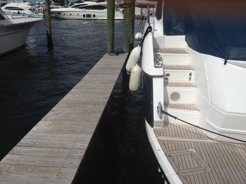

    The finger pier isn't very high in this picture but even there it s quite a big step down to the platform because yet again this euro builder didnt realize that boats in the US need boarding gates on the sides... And the first 4" where you d want to step are slippery gelcoat...
    Sure it has a retractable passerelles on the other side which doesn't work in this case because of a dock box in the way. And if you are tied along side a dock that stern passerelle is useless
  2. Pascal
    8,546
    Then you only get a single pair of cleats at the stern so if you need to a spring or any line leading forward it will rub all over the gelcoat...
    Then should you be adventurous enough to have a tender, there are no cleats to tie it up!
    Brilliant design...

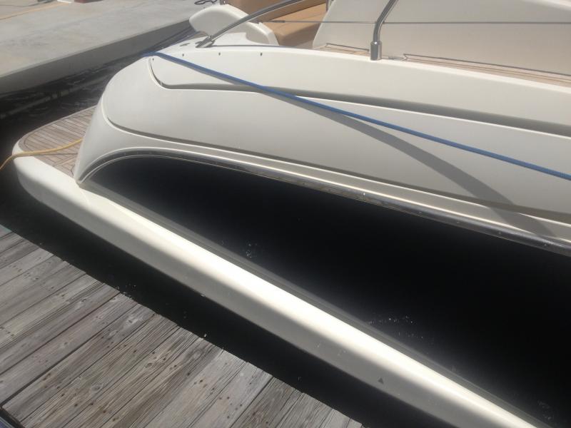

    But wait there is more :). At least on this one they installed a rub rail, which is pretty thin and only came in 6' sections... Probably shipping it in longer section was too expensive :)... But the bulge near the water line extend well beyond the rub rail so its shiny gelcoat is unprotected. Boats never back into narrow slips, ever!

    Maybe I'm missing something due to the prospective of those pictures. But can't you just step from the dock to the swim platform? Or is the distance you have to step down to great due to the tide at the time?
    The lack of extra cleats and/or proper fair leads is silly. But you could over come that by running your springs forward off your midship cleats.
    As to the scuffing, wooly line wraps would help. With designs like that, those should come as standard equipment from the factory.
  6. Pascal
    8,546
    At that specific dock and tide, yes, you or i could step down on the platform but I guarantee you that 3/4 of the people wouldn't be able to or would stress out doing so...
    There are situations where you need to, or it is easier to, tie a spring or something at the stern. Not having cleats that will allow a forward leading is just silly. For instance coming into a transient slip, it will be easier to set the springs from the stern so you can easily adjust them instead of having to get on the side deck.

    Come on guys. It's a boat. We step across spaces and over lines. A girl in spiked heels and a miniskirt could board that and not even be embarrassed. Only problem I see is that there's no way to run a spring from the aft cleat although I can't see if there's an aft-midship cleat.

    I agree with the above and if that stbd side gap is too big for you, you can get your self a wooden board of a suitable size and strength to bridge between the platform and jetty.

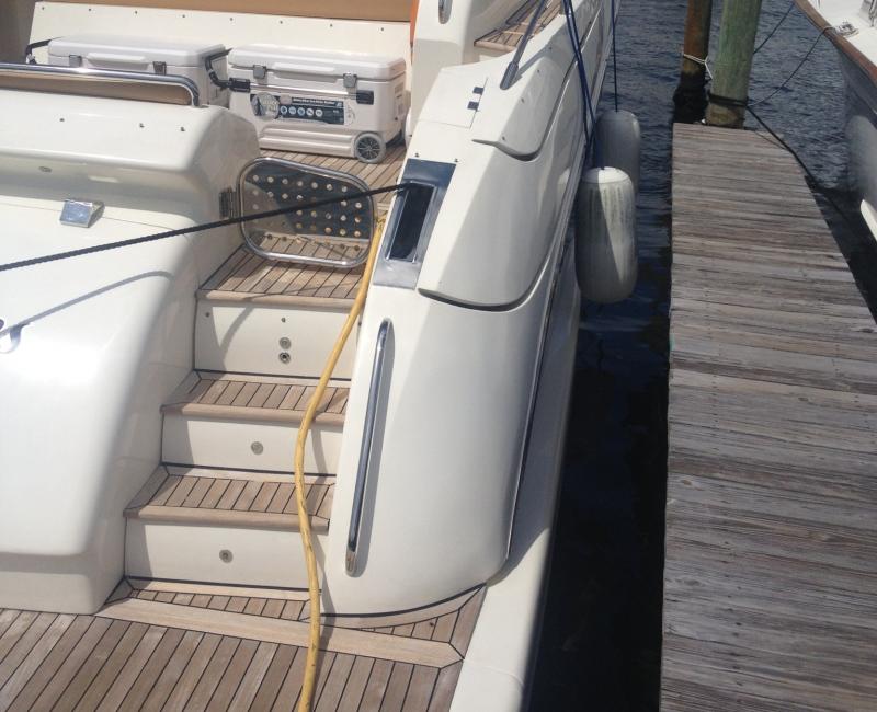

    And what, have it grind away the teak on the swim platform? Or maybe put a couple of rags of stolen green and white Atlantis towels to protect the teak? :) why not cut a simple boarding gate on each side?
    And where to store that plank?
    Here is another one... Platform is even lower and tapered making it and even bigger leap
