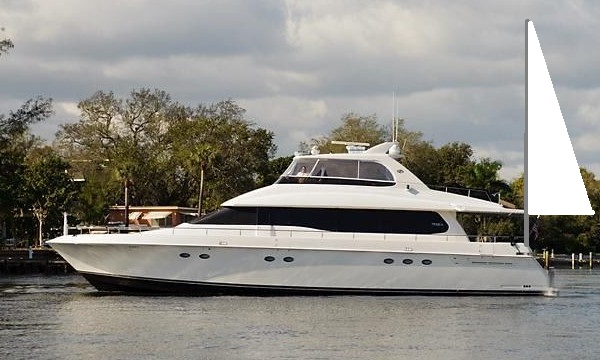

    Our Lazzara 68 doesn't behave well at anchor. The boat has a lot of height/windage, and she sways back and forth. As we have an all chain rode, when it gets to the far end of a "sway", it yanks the anchor line taught, with a big/loud jerk at the pulpit. The problem is a real issue in 10-20 knot winds. Wouldn't want to experience 30 knot winds.

    You could of cause just put the mizzen sail up. :D
