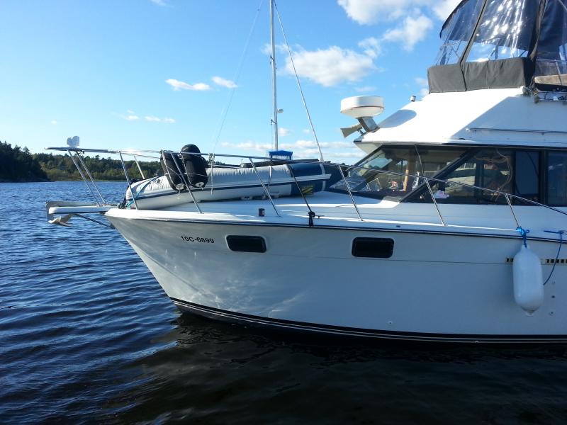

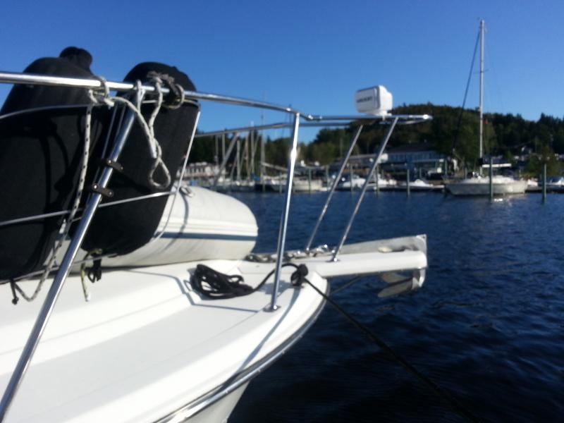

    Great advice All. Thanks very much...I have ordered the Lewmar 1000 and a remote as well. Should have it in a week or two. I have uploaded a couple pics and will get one close up looking down later today and post them hoping for installation location advice. Thanks again for the help folks.

    Can't see much with the dinghy there... Try to place the windlass as far back as possible without interfering too much with walking around.

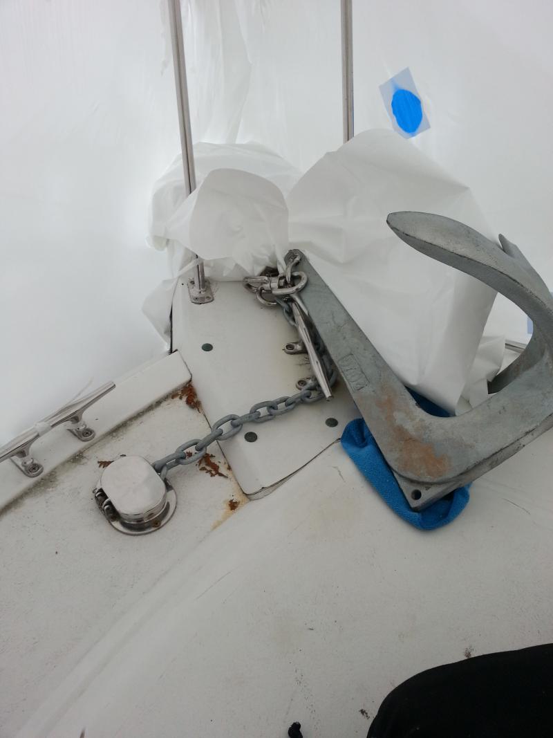

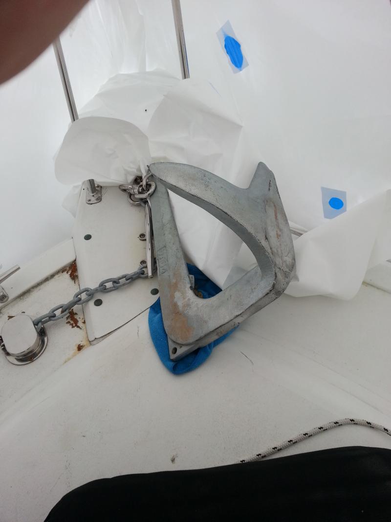

    Again thanks for all the sage advice. I've taken a couple photos this afternoon that show the area of the snout that I'll be dealing with for installation. Just wondering if I should configure the windlass to pull straight back or to place it so it will feed into the existing locker cover and place an idler pulley to permit lifting the anchor straight back along the bow extension.

    Generally the windlass will be mounted between the blue and black canvas and will feed directly through the deck underneath it (through the windlass). The cleat might be an issue.

    You can probably offsets it just a bit so the rode clears the cleat. Is that your only bow cleat or do you a cleats just behind?
    The problem is the offset hawsepipe. If the anchor locker is also offset and not on centerline, I don't see how you can install a windlass on that boat. A pulley or block may work but add complications and friction. Where is the anchor locker hatch on the foredeck
    Than swivel looks likes suncor. If so, remove it! Thy are prone to failure, I have lost a 110lbs Bruce in the mud of the Indian river because of such failure. I don't really see the need for a swivel but if you really want want, use a Kong instead.
