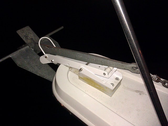

    My current and prior boat have above deck Horizon windlasses; never a problem with either. The only thing to add to prior advice is since you're going to the trouble/expense of a windlass, I recommend that your bow roller is 'self launching.' My current Carver came with just a straight and level bow roller, so even after installing a helm switch, someone would still have to go out to the bow and kick the anchor overboard. This I fixed by installing a self launching roller instead. I had to build up the platform a bit to get the downsloping angle so gravity would let the anchor slide off the front. Here's the end result:
