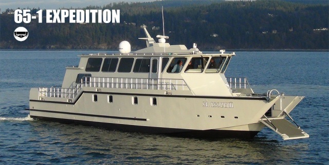

    If you are really in for an US built aluminum motor yacht, there would be a very good way of building a 60 feet fully custom planning boat in the CONUS. Contact a US based designer and naval architect. Have him make up some plans and calculations for your dream boat and then contact those guys in the Pacific Northwest.
    www.munsonboats.com
    They are most likely THE highest quality aluminum boat builders in the US and Canada. Munson Boats are spezializing in very sturdy work boats of highest quality, both for the metal part and for the machinery. If you provide them with a yacht design (they may even have some), they will be able to build a perfect yacht with great performance, that will outlast its owner for sure.
    They have built this 65 ft Explorer type "yacht" for a well known Russian Oligarch. Looks a bit rustic-style but is of great quality. I am sure, they can build a more elegant yacht type boat (exterior and interior) with the same quality. A bit more expensive than a production "plastic fantastic" but a dream boat Made in the USA.
    I would give it a try.
