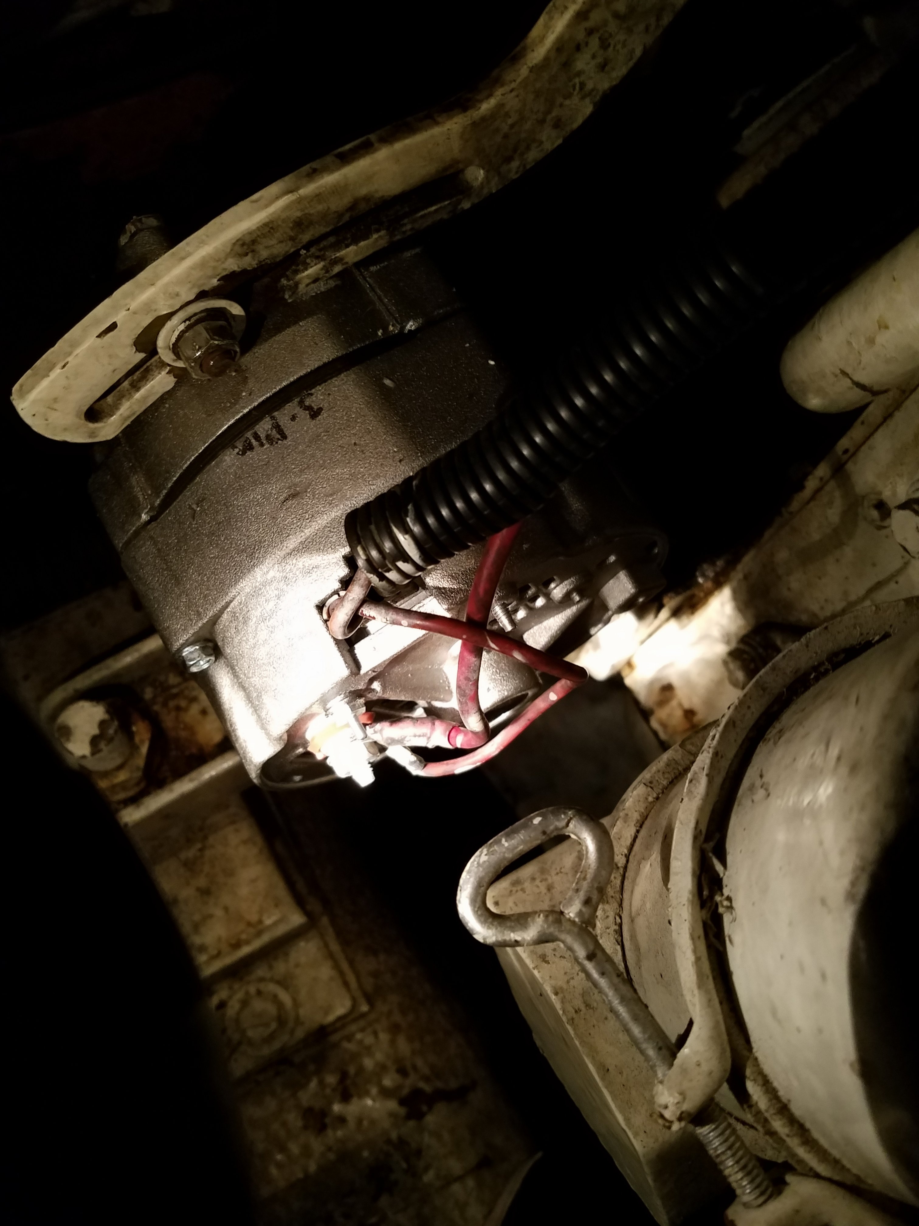

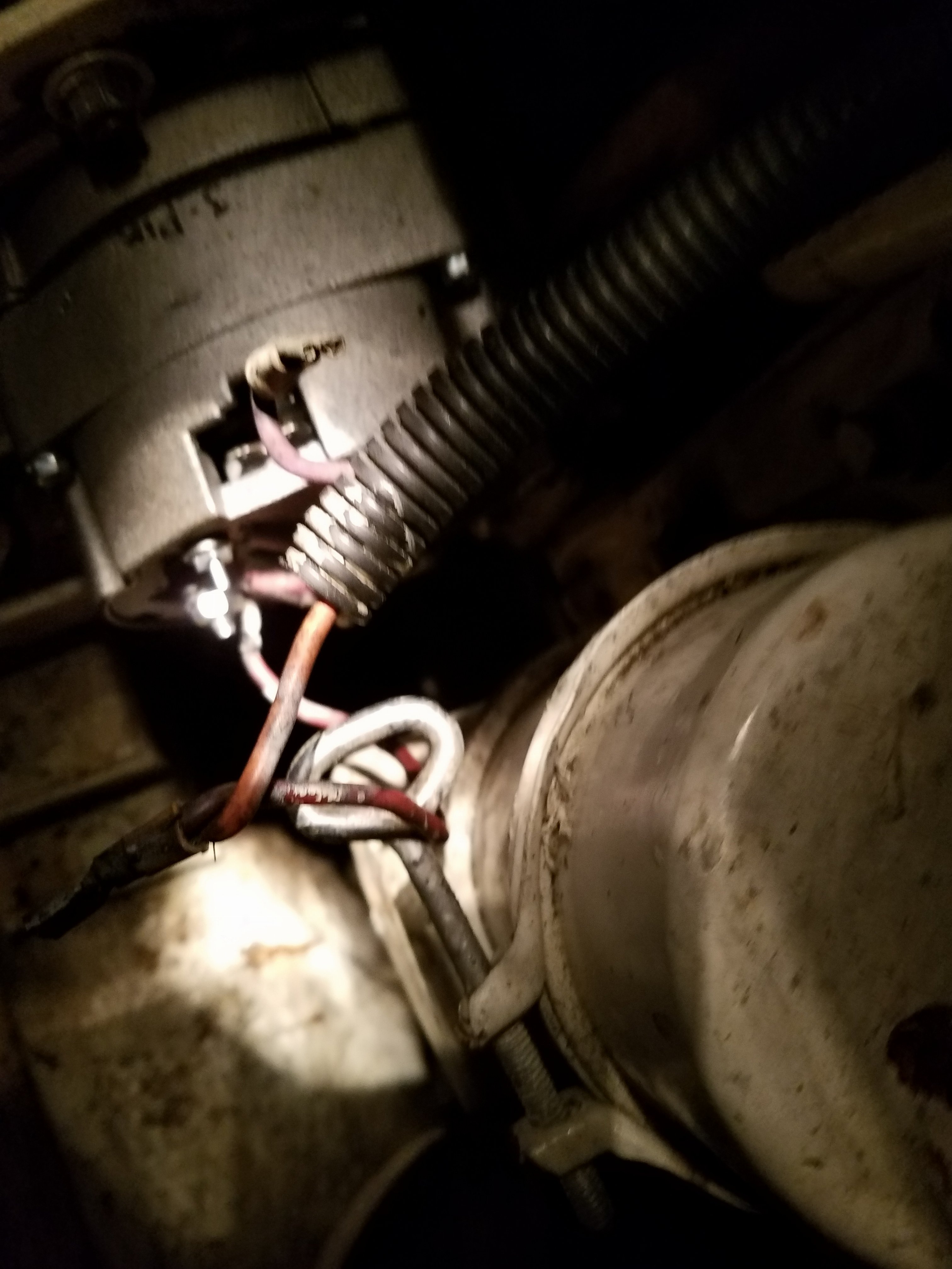

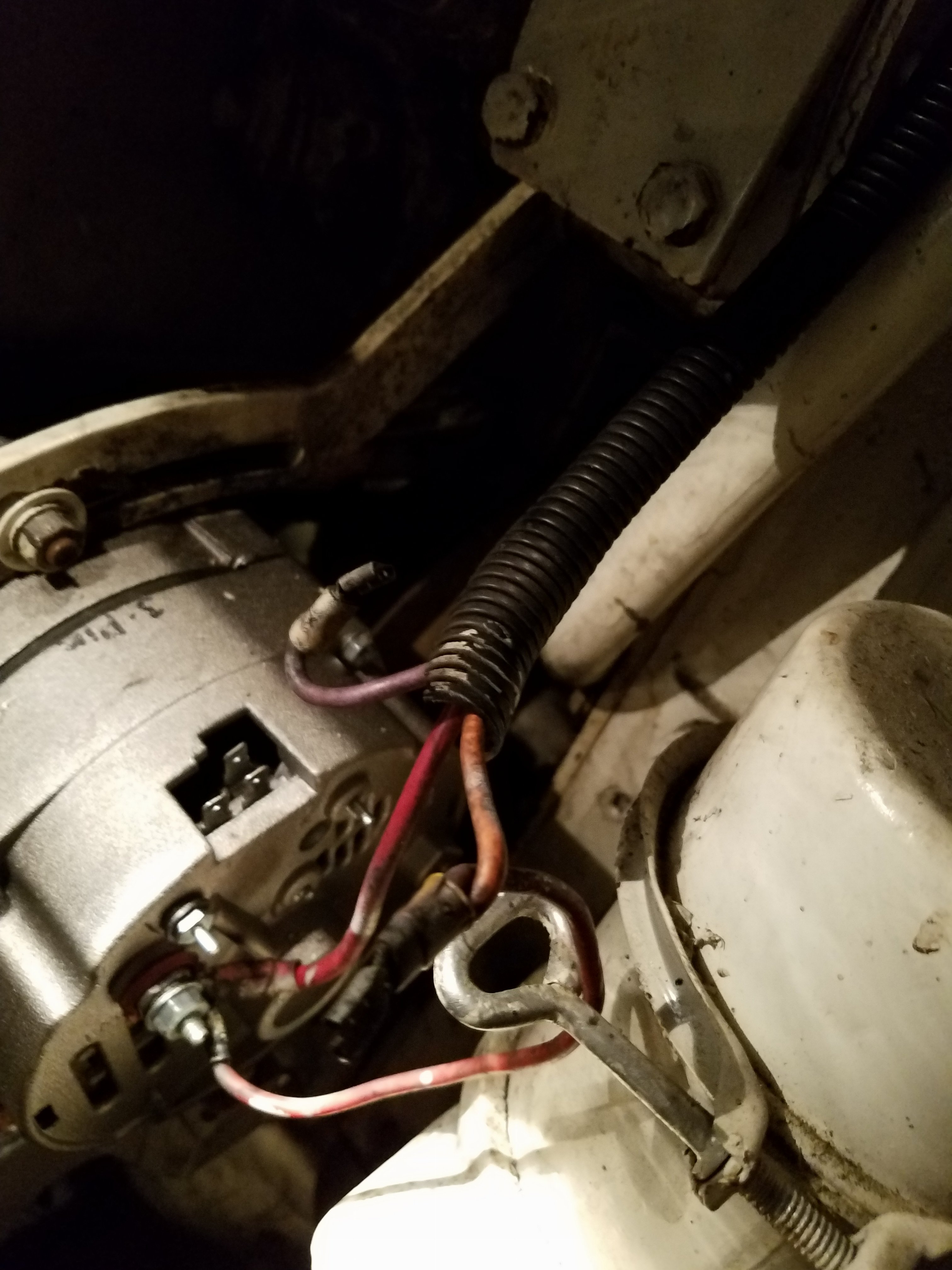

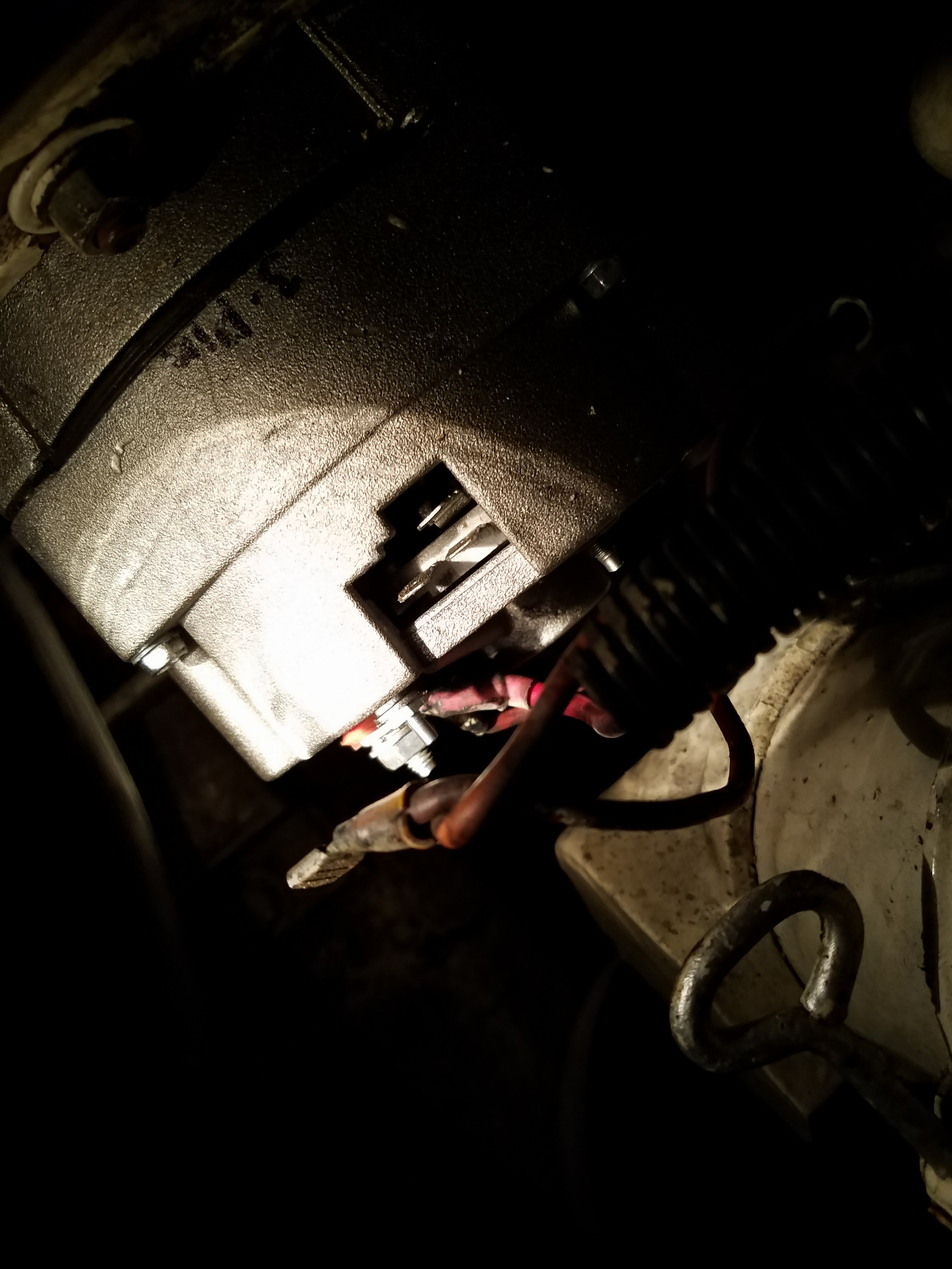

    Ok...at the boat and pics are too large to download...i have 2 reds coming off lug. One to spade and other to starter. There is also a orange attached to the red that went on the spade. There is also a purple on the spade...suggestions? I pulled the red and orange off the spade..the alt is warm

    No sliver of metal joining the spades together..wires removed from spades..i traced the orange wire to a bus bar and it is disconnected on both motors..cut off some time ago...the purple meet up with 2 reds at the bus bar and go somewhere...same on other motor...other alt is not warm

    Hope the pics are goos...i am not computer savvy with this phone

    O K, I'm just in and it's late.
    I see three pin connect.
    Leave wires off and it will be cool tomorrow.
