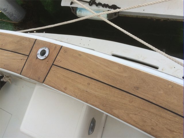

    But don't they turn grey over time??

  11. Capt J
    14,531
    I've seen the Semco stuff look like that picture and last a long time on a shaded aft deck. It did not turn grey at all, but did eventually wear off after a year or longer.
