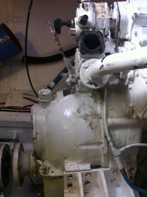

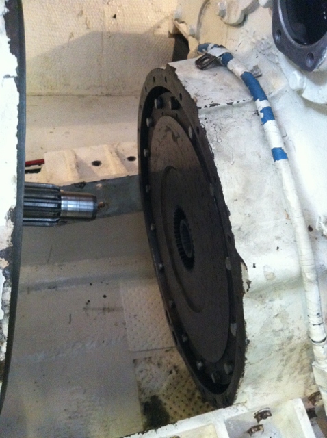

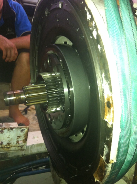

    Gearbox Repair

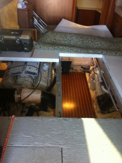

    Preparing the gearbox for removal from the engine. Then removing the Flywheel.

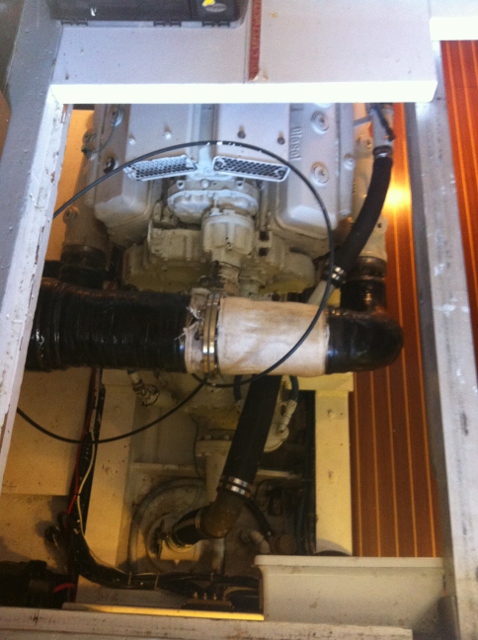

    I wouldn't want it more tight! One of the reasons I settled on this 53, in spite of the lack of "toys" was the engine room. Hate the idea of poking around an old ER not knowing what has been done by various owners over the years.
    Good luck RT46
  9. Capt J
    14,530
    Merritt's did an EXCELLENT job on George's boat in simplifying the electrical wiring, plumbing, and fuel lines in the engine room. Everything is very cleanly done and simple. The factory 53' Hatteras SF's have a birds nest of wiring going to several breaker boxes and hoses and crap everywhere in comparison.

    If I remember old stories, the MH gear had TWO service covers and the M only had one. With that in mind, Why is a M gear behind a 12v71?

    The gear is in fact an "MH" model. This can be ascertained by the rounded edge profile of the gear's bottom cover plate, i.e., sump. (See the second picture in post number 2.) A "M" model gear has a thin, square edged, flat bottom cover plate.

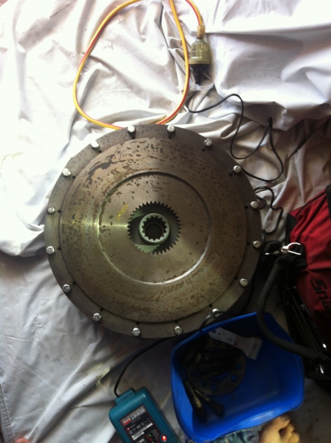

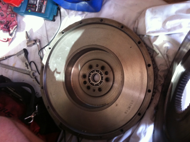

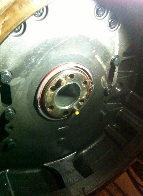

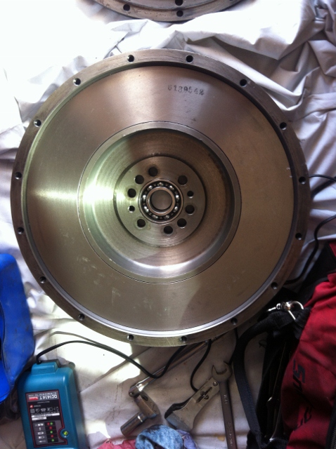

    Gearbox Repair
    Next stage of repairing the port gearbox, an Allison, finally is complete.
    With the help of a very knowledgeable Detroit mechanic, I have learnt a lot about my engines and the gearbox.
    We needed a new piston as the old one was so badly scoured due to the failed clutch.
    I could not get one in Australia and ordered one from Dieselpro.com in the U.S. Within 6 days it arrived in Brisbane, Australia. Great service.
    Next we removed the old rear main engine seal, then re assembled the flywheel, piston etc. and replaced the gearbox.
    I had the sea trial yesterday and all seems good. Although the first 5 minutes were heart stopping when I found there was little thrust from the engine and the revs were going way past the normal W.O.T.
    After going back to idle speed for a few minutes, then going to full throttle again and the prop now had “bite” and was running normal.
    I think it was due to the Hydreco pump needing to prime itself.
    Image 1: Flywheel.
    image 2 and 3: New Piston.

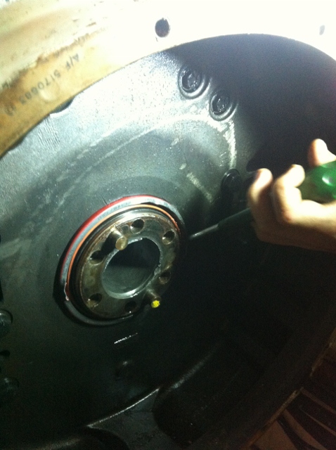

  15. Kafue
    Kafue Senior Member
    Nov 29, 2006
    1,166
    Gold Coast Australia

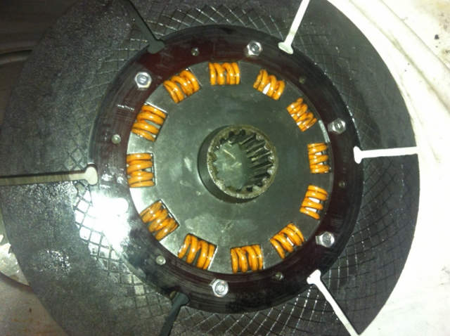

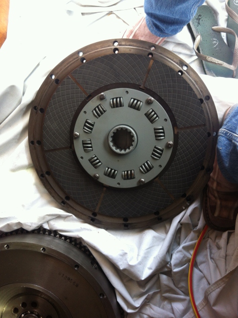

    New Clutch.
    Rear Main Engine Seal.
    Removing the old engine seal.
    Removing the rear main engine seal was a bit of work. First we tried with a screwdriver, but finally had to drill the outer metal part of the seal to break it and then pull it out.

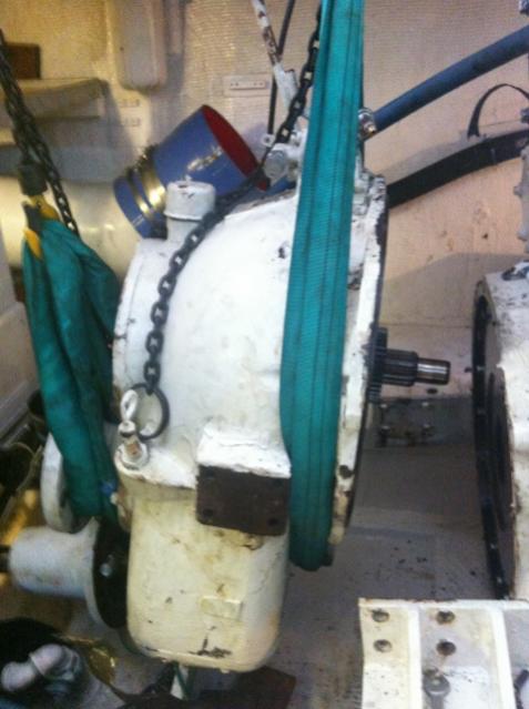

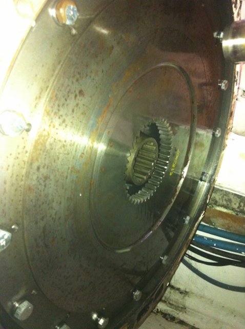

    Finally re-installing the gearbox
