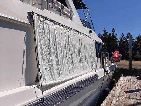

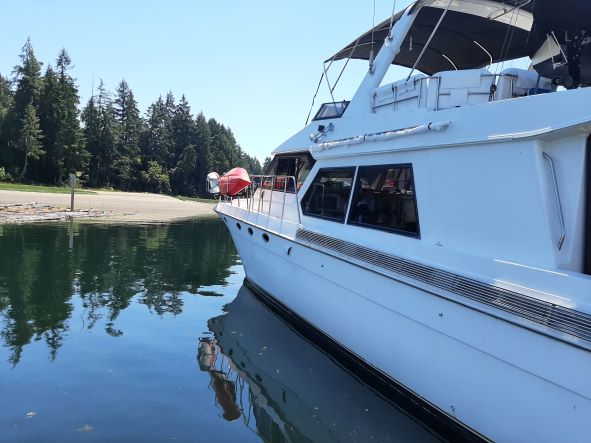

    I went cheap on my Navigator 5300. First, I purchased cotton curtains that had the rod loops on top. The tops of the loops were sewn end to end. The bottoms were shortened to length with a 2" hem.
    I cut 2 pcs of gray electrical 1/2" pvc slightly longer than the salon windows. One of the pvc conduits is weighted with a 1/4" metal rod on the inside. A 3/8" wooden doweling was installed in the upper one for stiffener. I then glued pvc caps on each end of the tubes. Velcro straps secures the contraption to the handrail. To secure, roll up the bottom and use the velcro straps to hold everything.
    Very easy to take apart to launder as needed.

    Oh, and under a $100 bill.
