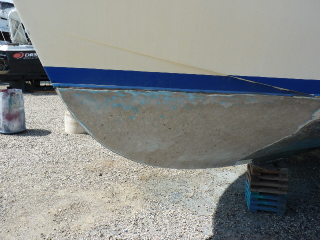

    Guys, great input. I have seen the Interlux info and following that process. The boat is on the hard and I have about 25% of the bottom peeled. All but two of the new blisters not previously repaired are very shallow, just below the gelcoat, two went into the skin out layer. I'll update later with some pix. Again thanks for your help. Fred

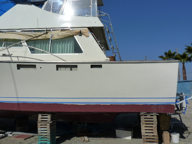

    The big box store paint stripping method was not very effective so I ground off the paint and gel coat to the fiberglass mat. Blistered and hydrolyzed areas were ground until good glass. The boat air dried until I got good water content reading. I used West Systems epoxy over the bare fiber glass and then while still uncured used West Systems and Cab-o-Sil (consistency of Mayo) to fill divots, while still uncured I covered the bottom with West Systems mixed with red micro balloons and Cabo-o-Sil (1 qt Cab-o-Sil to 2 pounds of red micro balloons). Allowed to cure then sanded to fair hull. Applied six coat of Interlux EP200O barrier coats every 3 hours and after 5 hours applied Interlux Ultra bottom paint in black then applied two more coat of bottom paint in blue. While the hull was drying I applied 4 coats of AwlGrip to hull topsides and fly bridge. I was out of the water a little over two months and accomplished many more maintenance items however I worked long hours mostly by myself to get it done in this short period of time.
