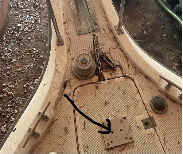

    Advice needed purchasing 1990 Tiara 3300 Open with Cummins 6bta.
    Hi everyone, I took a look at a 1990 Tiara 3300 Open with Cummins 6BTA engines today. It has been out of the water since 2019, it worked completely fine when put away but the owner passed away. I was looking to buy a boat, put some tlc into it and resell or keep it. I was wondering if there's anything I should specifically look into regarding this particular boat and what it would be worth as is, how much would need to go into it, and then what it could possibly be sold for. Here are some pictures, would not let me upload the interior walkthrough but the interior is in good condition. Thank you guys so much.

    6BTAs are good engines but may need some serious work if they ve been sitting for 5 years. The whole boat is going to need a ton of work… all pumps, air cons, heads… you won’t know what will need to be rebuilt until the boat is in the water and every system tried.
    Now if you can do a lot of the work yourself, it may work out but if you have to pay $100-150 an hour… forget it.
    now, that picture showing the fuel tank… is that white box the generator? If so…. Run!!!

    Yes, we also have a Whaler with 6BTA from a similar year and they have been good for us. What is wrong with the generator? Just wondering, I don't really know much about marine generators. How much do you think this boat is worth as is?

    Well you have a couple of inches between the gen and the tank!! And no space to drop in thru the hatch.
    any maintenance on the gen will cost you four times as much.

    Tiara builds a solid boat. The MC registration would indicate it's a fresh water boat. It will likely clean up nicely but heed Pascal's advice. This is a 34 year old boat.
    Also, please read our rules on image sizes and hotlinking. These pics will be removed because the host can change the image. You can re-upload the images as attachments, but don't hotlink.

    the problem is that until the boat is cleaned and launched, nobody will know what it will take to get it in running condition I d guess at least $20/30k if you re lucky and the gen / engines / gears dont need full rebuild. If they do you could be looking at $60k, $70k or more.

    If it was operational, it's $40k to $50k boat. Without knowing if the engines, genny, running gear and electronics are operational, you could easily spend that amount (or more) to restore it. Get a local marine mechanic or preferably a surveyor to supply estimates then submit these figures to the seller along with an offer based on how much you will potentially need to spend to make the boat operational.

    I ll ask again: how. Do. You. Get. In. That. Hole. To. Work. On. It.
    impeller, belt, oil filter, secondary, The fuel valves are against the sound shield!

    What do you bolt down to a hatch cover??

    Maybe your setup has a little more room around the genny and offers reasonable access. The picture posted shows a serious access issue. Nothing insulting and no attitude….i didn’t mean to hurt your feelings.
    whenever I have looked at a boat to purchase, access to various system is at the top of my list. That picture alone so enough to make me not even consider that boat, even if in mint condition.

    It’s a 33’ boat. There’s only so many places to put a generator. The worst place on a small boat is between the motors in my opinion.
    I’ve dealt with many generators centerline in the cockpit between fuel tanks. All the panels come of with quick access to everything. Only the corners of the frame remain in place. You have to work mostly from the top down. It’s a non issue really.
