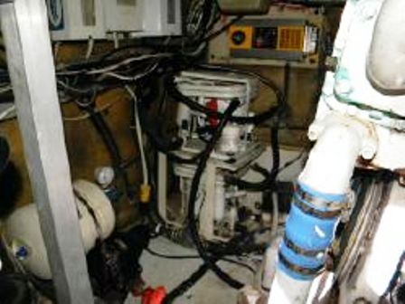

    I am going to add a 12V pump to the fresh water system while keeping the current 110v pool pump. I like the large pump because it is quiet and great pressure. I anchor quite a bit and running out of water when the gen is off is inconvenient. I know I can figure out how to T off the water feed and into the copper plumbing. Just curious if any of you have a two pump setup and have a pic just to get an idea of how it is plumbed. This picture is from a sistership but the same setup I have.

    Seattle, WA

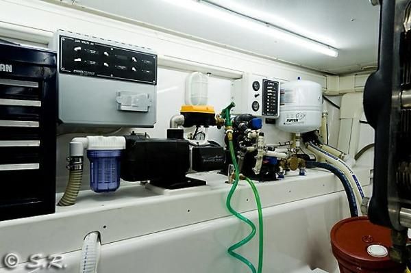

    Here's a setup I did with a Stingray 240VAC pump primary and a Jabsco Dual-Max 12VDC as backup (it's kind of lost behind the hose). Both pumps have their own seperate inlets so only the outlets needed to be valved, breaker panels right above them and the water tank is integral beneath the shelf they're mounted on.
