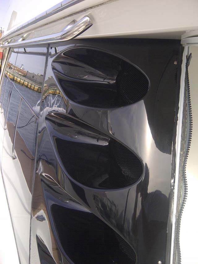

    I have a 99 Voyager. I removed the black engine room air intakes for repaint a while ago and seem to remember seeing the flybridge drains behind them. Not a big job to remove the intakes, I think 6 or 8 screws and removal of the caulking around the unit. The intakes are directly aft of the large salon windows.
    The rear flybridge drains dump out of the transom onto the swim platform directly below the fuel fills. You can see the tee where the flybridge drain hose joins the cockpit drain from the engine room ladder. I would think that you may find a disconnected, clogged or broken hose/fitting behind the air intake allowing the water to enter the roof of the cockpit area. Good luck.
    Rich

    This is the air intake I spoke of on the 99 Voyager. As you can see it is directly below the port drain of the bridge.
    Rich
