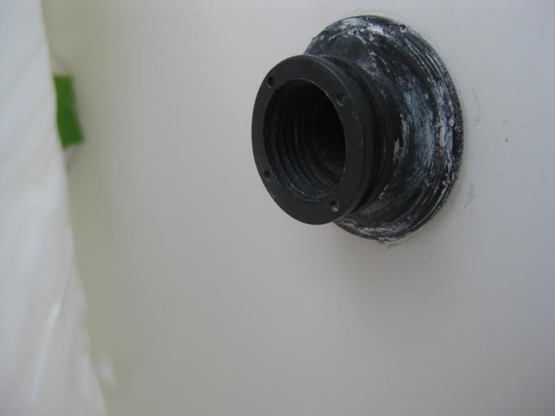

    Fuel vent caps missing. Black ridged nipple coming out of hull. Cant find hose on inside of hull. Any clue of manufacturer??
    THX

    IMG_2206.jpg here is pic of thru hull. Need cover....

    Thanks but I have checked West, Attwood, Perco and Forespar. Of course I can not find hose's inside hull.....

    It will most likely run off your fill neck or fill hose.

    Are you saying this is on the side of your hull, starboard side. The fill caps for fuel are on topside port and starboard on the walk way. This to me looks like the exhaust fan from the cabin.

    I do believe that is an Attwood 90 degreee P-trap fuel vent.
    They have slightly modified the design over the years and the current one is
    Part number 66419-3.
    The second one on the list. It is the one with the SS cap instead of black plastic.
    90° P-Trap Vents : Attwood Marine

    Thanks gbarger, was able to find replacement caps through that link. On order...

    Go to the Attwood site and get the color number you want. I ordered mine through West Marine. You will have to buy the entire trap vent and screw of the cap. I went with white to mactch othe through hull drains. No big deal as they are cheap. Hope this works for you..
