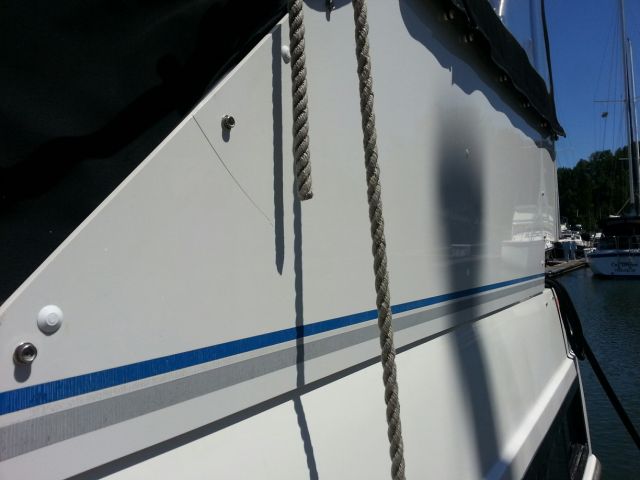

    Arrgh! My neighbor crashed into my port side aft deck dodger panel and put a 7" crack in it. I've got an idea on repairing it and avoiding having to refit all my aft deck enclosure. If I can't find and entire panel, I only really need a section of panel about 10"x12". So even if you've got a broken one lying around, that I can get four 3"x10" pieces cut from it, I would be very happy.
    Also, if anyone knows, specifically, what the material is and if a particular adhesive will bond two pieces, please let me know. The local plastics fabricators tell me there are 78 different adhesives for various specific types of "plastics".
    Nick, Portland, OR

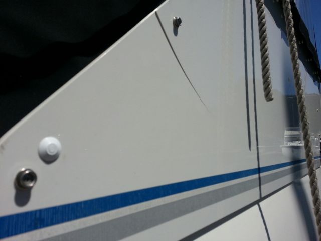

    It is a crack and no pieces are missing. I will need to drill a small hole at the end of the crack to stop it from spreading. My thought is to glue some reinforcing pieces to both sides of the dodger with a cap around the sloped edge of the dodger. I would do this to both the port and starboard sides to make the repair look like a standard reinforcement. Initially I thought the material was fiberglass and had a fiberglass guy look at it. He said it is some "plastic" material and that he did not have the skills to repair it. For now, I'm trying to find exact match material for the reinforcing patches.
    Thank you. Nick

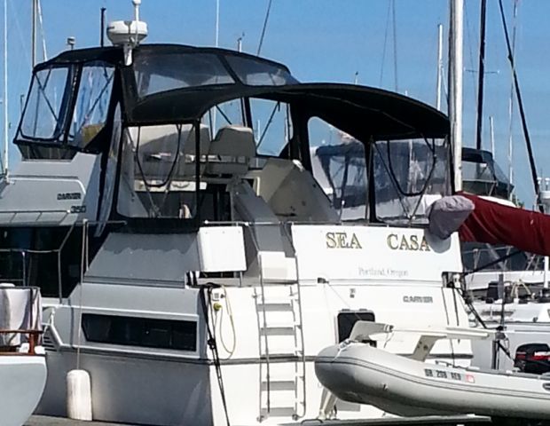

    Sorry for the dumb question, but what is an aft panel dodger ?
    Picture would help
  9. NVeroske
    NVeroske New Member
    Sep 4, 2005
    15
    Portland, OR
    It is the plastic "surround" for the aft deck. I hope the photos attached. The portside panel has the 7" crack in it.

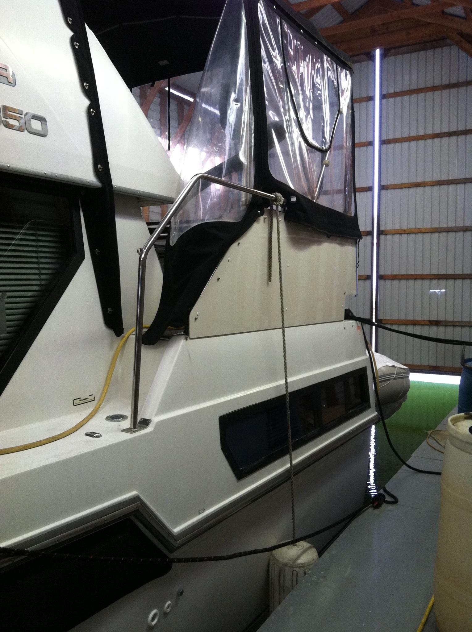

  20. timjet
    timjet Member
    Jan 6, 2010
    129
    Tampa, FL
    On my 98 Carver 355 the plastic white rivets that attach the dodger boards to the stainless steel rails got brittle from the sun. Cruising in the Bahamas a couple of years ago doing about 18 kts the dodger board on the port side came loose due to the wind load and brittle rivets and fell in the water taking the aluminum corner piece with it and the small section of dodger board on the aft next to the stairs just like NVeroske as shown in his first picture. There was probably over $1000 of dodger board and aluminum corner piece laying in 10 ft of gin clear water. With difficulty I dove and retrieved the lost section. Once home I removed all the plastic rivets and replaced with SS screws and acorn nuts drilled through the stainless rails.
