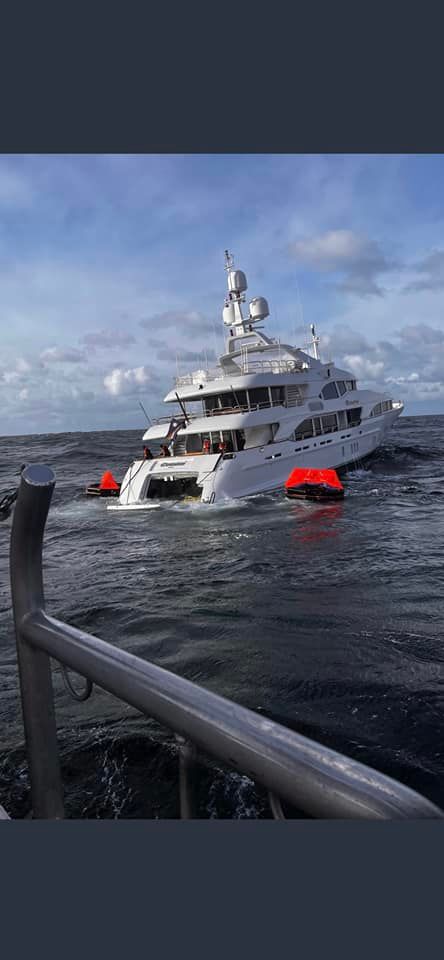

    Video out there online of 45-meter "Domani" floundering 45 miles off of Greys Harbor WA. in heavy sea unable to close its stern door. Couldn't link the video. Coast Guard is on scene but doesn't look good for the vessel.

    Well that's good news. The color video that I viewed was directly into the stern beach club area with tons of ocean water aboard and mucho free surface area sloshing back and forth with the rolling motion of the vessel. Aft engine room and Benetti's infamous lack of water tight bulkhead penetrations made me think that this wouldn't end well for the vessel. Better videos are out there and will be forthcoming.

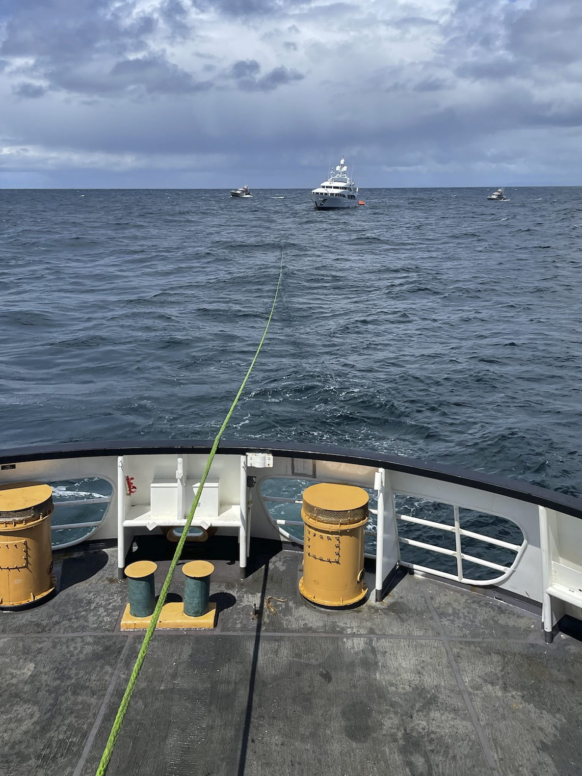

    Latest report is CG handing them off to another tow and they'll head on up the coast toward Neah Bay, likely destined for Port Angeles.

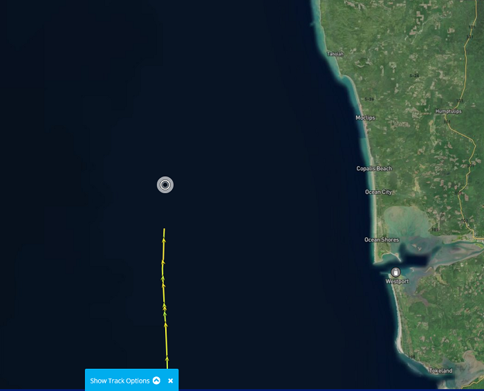

    Per yesterdays AIS, she was heading to Port Angeles. About the same time all of this started, her AIS went down or out of range. No AIS since.

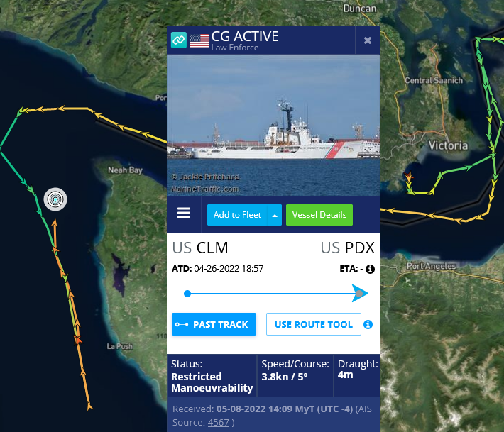

    I'm guessing the CG is still towing her. Here is a larger CG boat, Restricted Maneuverability, moving at 3.8 kts.

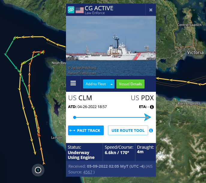

    Looks like the tow was passed off.
    I missed it.
    Still no AIS from the casualty.

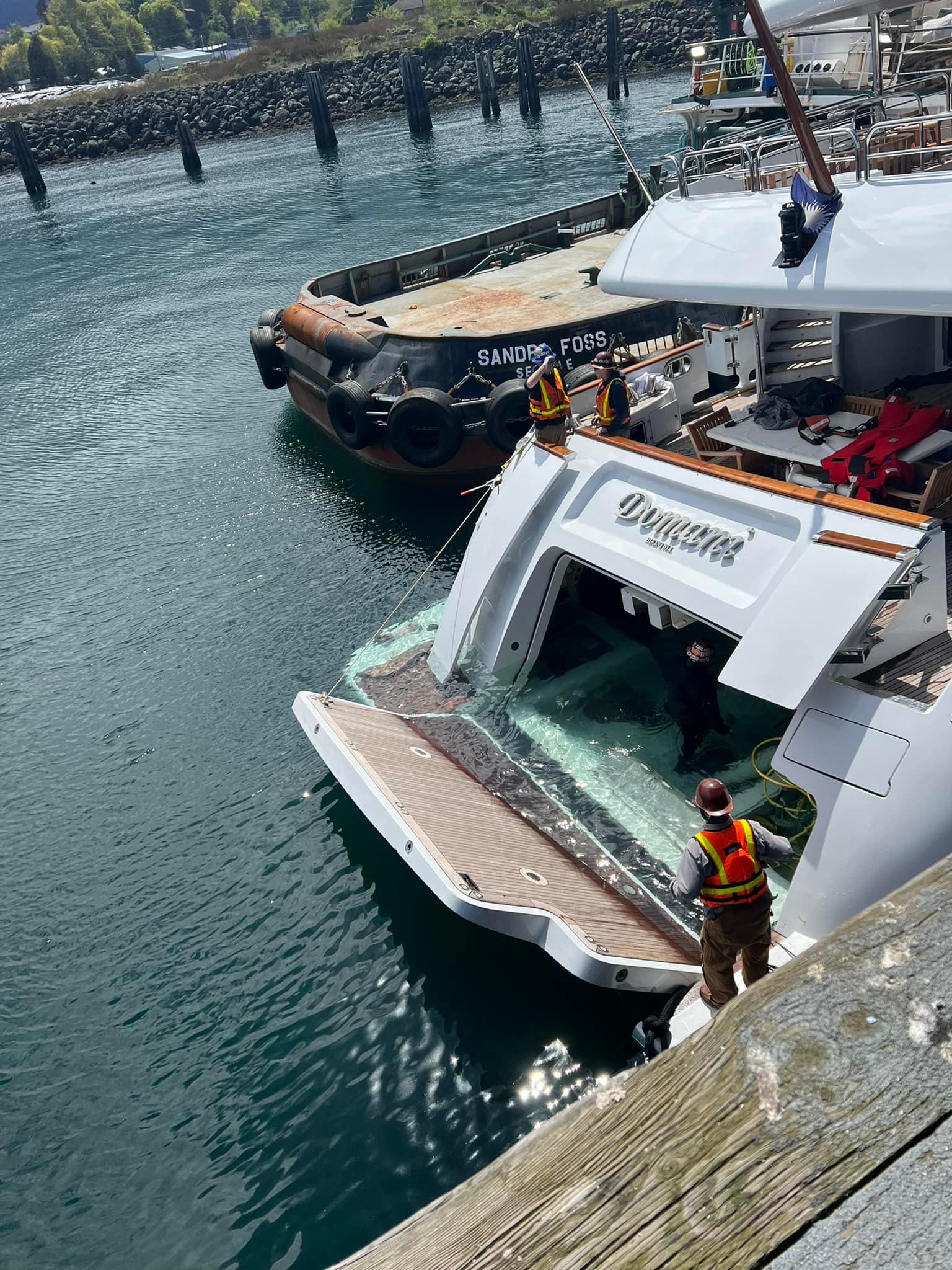

    Alongside and secure. Now the damage assessments begin.
