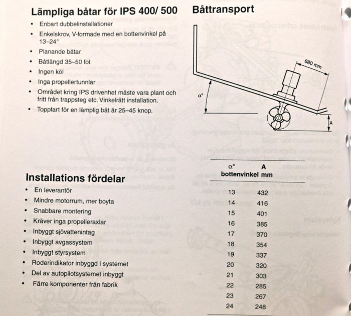

    5,380
    In my IPS installation guide from Volvo Penta they say from 13-24 degrees deadrise...

    Does it say this? If so, It seems to me that they don't put their money where their mouth is.
    Aside from being personally aware of builders who were strongly recommended by VP engineers to keep any hull meant for IPS installation nowhere near 15 deg at most, VP must have suggested also at Delta to NOT follow their own installation guides, if you check out this photo.
    As you know much better than myself, the hull area where the pods are installed (which is what really matters, more that the closing aft deadrise) is practically flat.
    Even just based on the photo, I'm sure to exaggerate if I say that the pods are outward angled at 4 or 5 degrees, if that.
    And rightly so, mind: I'm not saying that Delta made a mistake - if anything, it's the installation guide that you mention which is laughable.
    Make the pods rotate along a 24 deg axis, and when hard steering at speed any boat would risk to capsize, courtesy of the listing moment introduced by the pods thrust! :confused:

    My installation guidebook is not new, so they may have changed this today, I don't know. But we had a hard time to get our hull accepted by VP, probably because it would also work well with Zeus at the time... And yes, the drives are in a 5 degree angle.
    But again, this is not what VP recommended and not what most other brands are doing, most of them are using their existing hulls without modifications for IPS and most of these are getting a lot better performance figures than with straight shafts...
    In Swedish.. ;-)
