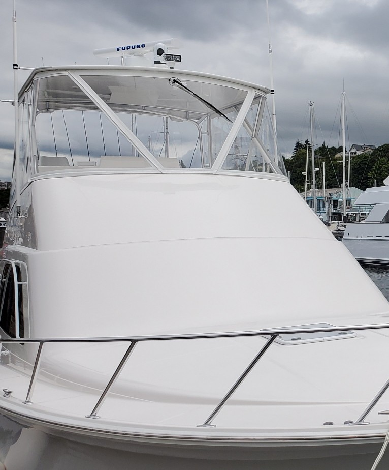

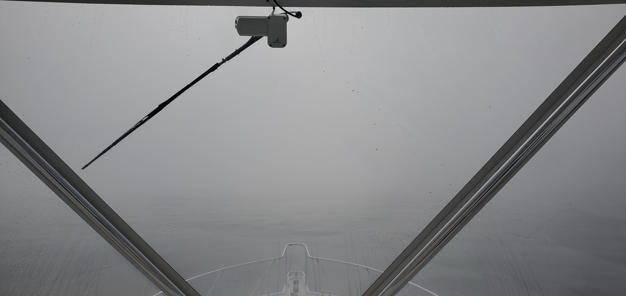

    I have placed a single wiper on center line on my last two flybridge boats. I have enclosure built with a thicker center panel to reduce inflection at higher cruise speeds so wiper has flat surface to sweep. A must for the light rain and fog we see in the PNW.
