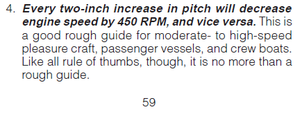

    No.
    Quoted from the Caterpillar Marine Application Guide:
    They are giving a rule of thumb of 450 rpm/2" pitch = 225 rpms per 1" of pitch. I toned it done to an approximation of 200 rpm gain per 1" pitch reduction. He has at least 400 rpm to make up, by your method he would need to add 400/50 = 8" of pitch which is unheard of, then you go back to recommending a 2" Pitch reduction for every Ocean which lines up with EXACTLY what I said.
    Do the math.

    Generally on a 2300 rpm diesel inboard, I've always seen 1" of pitch gets you 50-75 rpms. It also depends greatly on the reduction ratio as to how many rpm's, 1" of pitch will change the rpm's. On a 2:1 reduction (or less) 1" of pitch will change rpm's a lot more (twice as much, all other things being equal: boat type/HP/speed) than on a 4:1 reduction. Is the CAT marine application guide that you're quoting is from a higher rpm diesel such as a 3208 TA?
    According to a calculator......it's showing the same results that a 1" pitch change is around a 50-75 rpm difference on a 2300-2350 rpm engine. Plugging in a 2:1 reduction, 40 mph speed, 36" pitch gives 2347 rpms, 37" pitch gives 2283 rpms, 35" pitch gives 2414 rpms (this is with prop slip set at 0, and calculating RPMS.
    www.heringpropellers.com/prop-slip

    The rule of thumb from the CAT Application Guide book is not engine specific, works great on Detroit's, Cummins, MAN, MTU's, etc. Great for ratios from 1.5 - 2.5/1, like practically most boats out there.
    The Prop Calculator site you are referencing is not relevant for this discussion as it is mainly for propellers that are operating at high speeds in or near super-cavitating regions, surface piercers and sterndrives that are going airborne, applications that account for a lot of aeration. Has nothing to do with diesel inboards and conventional shafting/props remaining in a submersed environment.
    Getting back to the cleanslate's situation - he needs to make up 400/500 rpm. Are you advocating that he remove at least 400/50 = 8" or 400/75" = 5.333" of Pitch?
