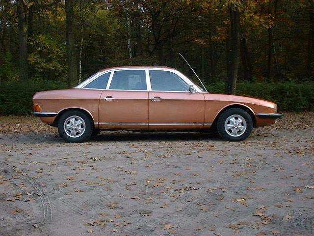

    I am very familiar with Wankel type or rotary piston engines. And I had to learn it the hard way, as I had a car with a Wankel engine. The 115 HP, 4 door sedan NSU Ro 80 (now Audi). A great car, far to advanced for its time but the engine was not very reliable and most of all not full power steady, a very bad behaviour for me as a young driver and even more for the German Autobahn (no speed limit :) !). Means, the engines did not last very long.
    When two Ro80 cars met on the road, the drivers raised their fist as a greeting. The amount of fingers raised from the fist counted for the numbers of engines already used up in this car. Good thing was, your engines never left their warranty :). They always died before. That was the main reason Audi stopped production of this car. And presently I have a EASA and FAA certified 56 HP Wankel engine in my powered glider.

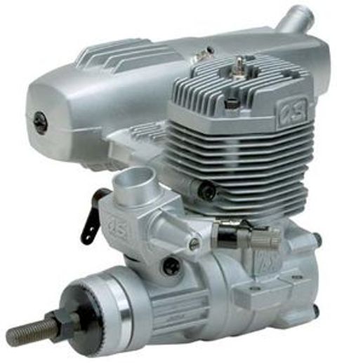

    But this little engine would probably be great for RC model planes and helicopters. Much better than those little OS Max 2 strokes. They would fit perfectly in one of your helicopters Carl.

    A 1.05 size OS heli engine weighs in around 30 oz with a muffler and makes 3.75 horsepower, so HTM's post brings good counter-weight to the discussion. Pun intended.

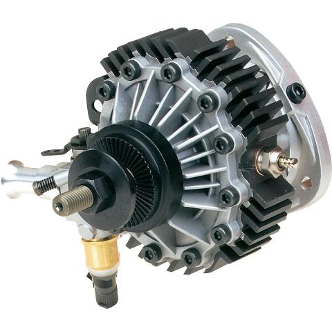

    Carl, how about one of those, the OS max Wankel. My youngest son had one in his RC plane. Did not last very long. Ended up one feet deep in soft ground after vertical impact. The engine did not survive :). But had a great sound, when still alive.
    OS max Wankel.jpg After that crash, my son transfered to 4-strokes. Much better sound and no more nitromethan fuel (awfull stuff). Now he is on electric engines only.

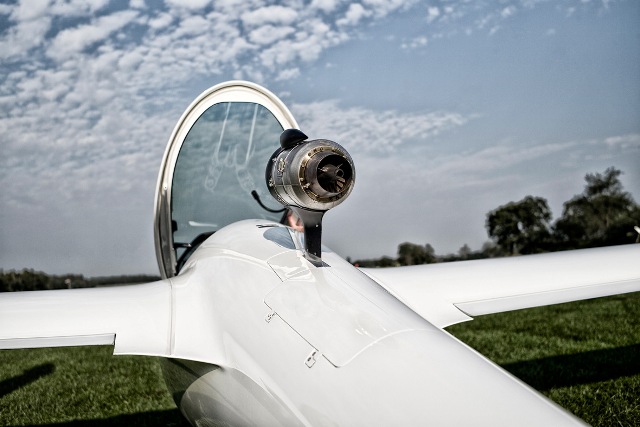

    A guy in our gliding club just bought one of those, A glider with an EASA certified retractable jet engine. Climbs out like a lame duck but makes a noise like a Lear Jet.

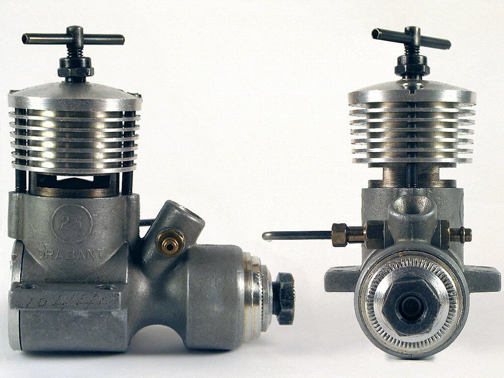

    Cox Pee Wee, been there, done that.
    Surprised those engines took the abuse at the high RPMs they spun at.
    My finger tips also took the abuse of trying to start them things.
