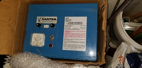

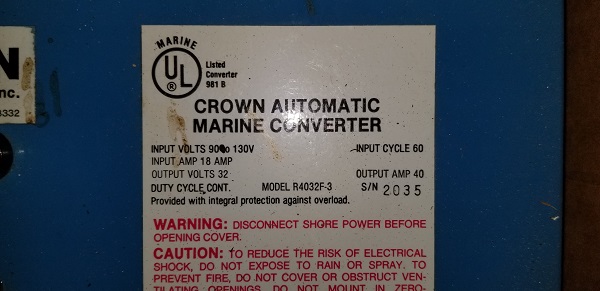

    Just found in my inventory a new Raritan / Crown, 4032F-3 battery charger - converter.
    I thought it was a 24v charger when I was reaching for it to sell.
    I know there are still some hardened 32v boat owners out there who could use some help.
    The pictures show some stains on the face. These are storage stains from sitting on the bottom of piles for a few years in a couple of my shops.
    I'm thinking around $300 plus shipping. Mind you, it is heavy.
    I can take offers or trade.
    Local pick up in Zip 32189.
    L45 manual is found here;
    https://www.raritaneng.com/en/tech-support/owners-manual-exploded-parts-view-promos
