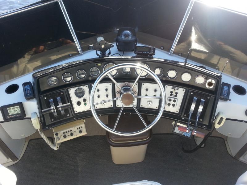

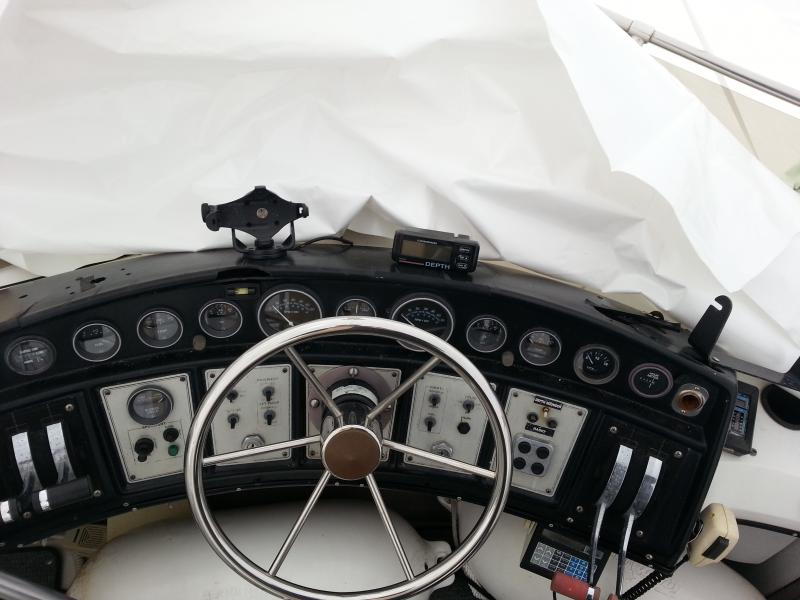

    Does anyone out there know where I might be able to get an instrument panel for the flying bridge of my 1989 3207 Carver? Mine (pic below) has been abused over the years; cracked, holes from installations etc and I would like to replace it.

    Lots of luck, but if you find one let me know.
    I've been looking everywhere and can't find one.
  3. Pascal
    8,164
    Fill th cracks and holes then get an upholstery shop to cover it in black vinyl.

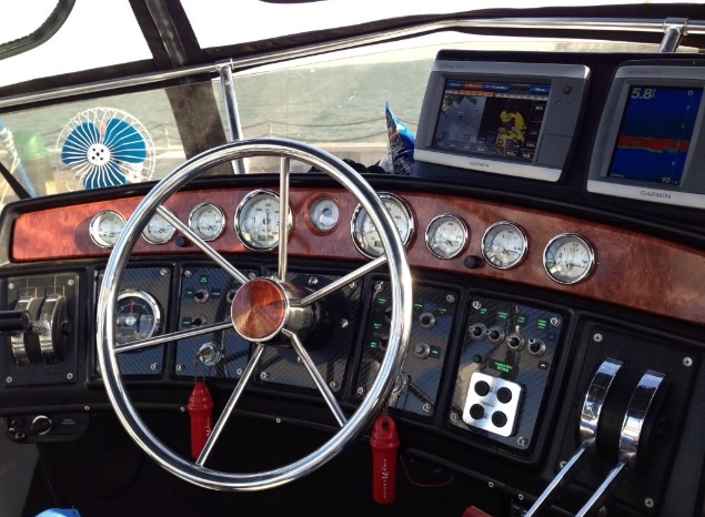

    This is what I did on mine. Carbon fiber lower panels with back lite letters. New benzle and gauges above. I have more elsewhere. My boat is little and old. I do not belong here. I am little.

    Nicely done..

    What a beautiful result!! Great Idea, Thanks much.

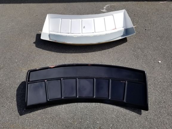

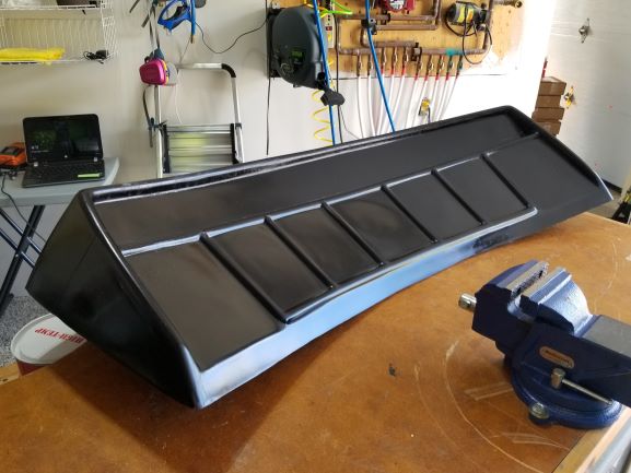

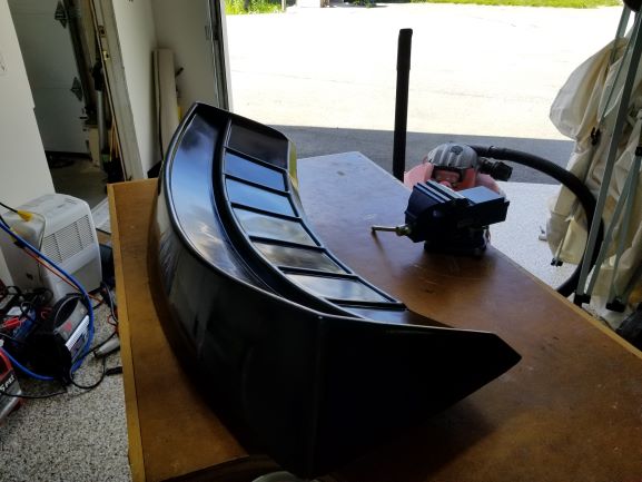

    Hey 1000 Islands, If you are still on this forum and are still looking for a fly-bridge instrument panel replacement I finally have the solution. I finally stopped looking and decided to build my own replacement part. Made a mold from the original after filling in all the holes and cracks then made a new part using black Gel Coat reinforced with fiberglass. It is UV resistant, 10 times stronger and better looking than the original plastic part. I'm going to make another one out of carbon fibre next. Give me a shout if your still looking...

    Nice job and what is your cost for building one for others
    ray
  20. No Worries
    No Worries New Member
    Sep 24, 2013
    23
