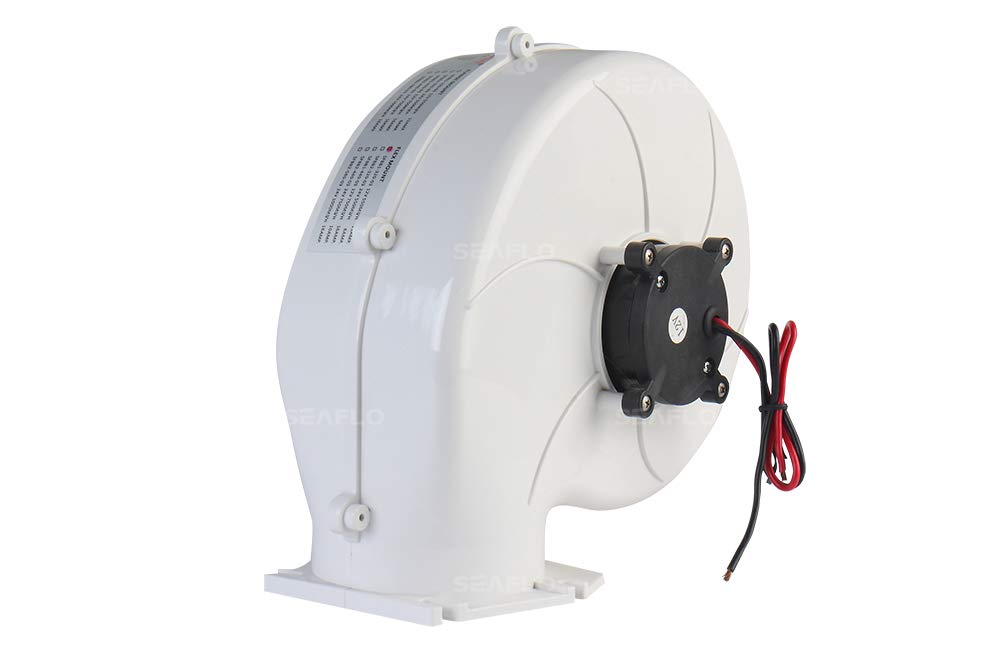

    Same CFM as the Jabsco one already purchased but mine does not appear to be their continuous run model, nor was the OEM ones Bertram installed. The other one, SeaFlo brand I purchased has a higher, 320 CFM rating and instead of one year, has a 4 year warranty but 2 of the 4 flange mount slots are off about a 1/2 inch, the intake instead of 4" is 6" and I was told a better type motor so once I get them installed will see if one holds up better. Last year I replaced a Jabsco macerator pump, also with a SeaFlo brand for a fraction of the cost and its been doing just fine so only time will tell how this blower does in comparison. Brand new was only $70.00.

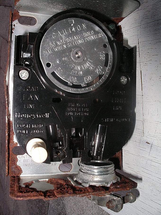

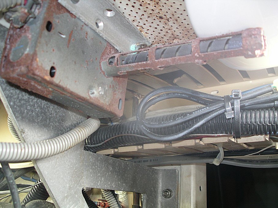

    Anyone know what this nasty looking thing at ER ceiling is ? Appears to have a 14/2 wire going into the box. Maybe some type of thermostat to control the blowers ?

    Way different looking from my blower control.
    Oh, My control is common on some other Bertrams I have worked on, that were so equipped (not all had it).
    I think it was a common part when installed.
    Yours sure looks like some kind of heat sensor.
    Center line aft in the E R?
    From the look of it's installation, I'm not calling that factory.
    Maybe a replacement by a previous owner.
    Time to start following wires.
    Hopefully somebody will recognize it and call out a brand or model spec.
    Is that really Greenfield (flexible metal conduit) running to it?
    Very top left of picture.
    Or more of that plastic flex seen below that gizmo.

    It's all plastic and yes the "gizmo" is center just inside the entrance from the cockpit. Was going nutty this afternoon with strange readings till I discovered my multimeter was howling for the trash bin.

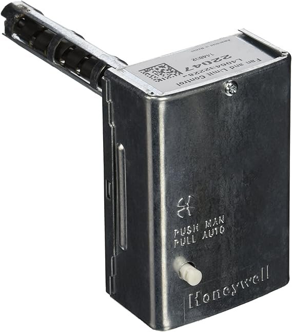

    Evidently it's a common Honeywell fan control for land buildings with an internal N/O spst switch that controls a solenoid in the 24 V. salon panel. Looks like its designed to mount on the outside an air duct with the probe inserted. Highly doubt original. Inside of the "gizmo" doesn't look bad but seeking a better replacement that like this one does not need an additional source of power aside from the 24 volts that it also switches. Maybe Danny at High Tide has something.
  19. Capt Ralph
    12,978
    Mine is Honeywell also but does not have that probe.

    With the 2 wires (ground & 24 volts) for the Honeywell joined the solenoid gets energized and has 24 v. at its output terminal however the ends to the blowers only have 3.5 volts. Ground is good so suspect the solenoid's internal contact may be going bad thus preventing enough amperage. I saw the Fireboy in a wiring diagram but not sure the one in the Bertram "book" is for mine but recall its terminals being clearly marked so its on the list to also check. Interesting how your Honeywell has no probe. Are you sure its turning blowers on when ER is warmed up as all of the ones I found on several sites have either a 5, 8, or 11" probe. When working on the ER alarm I used a heat gun to test the sensors but this thing was never checked.
