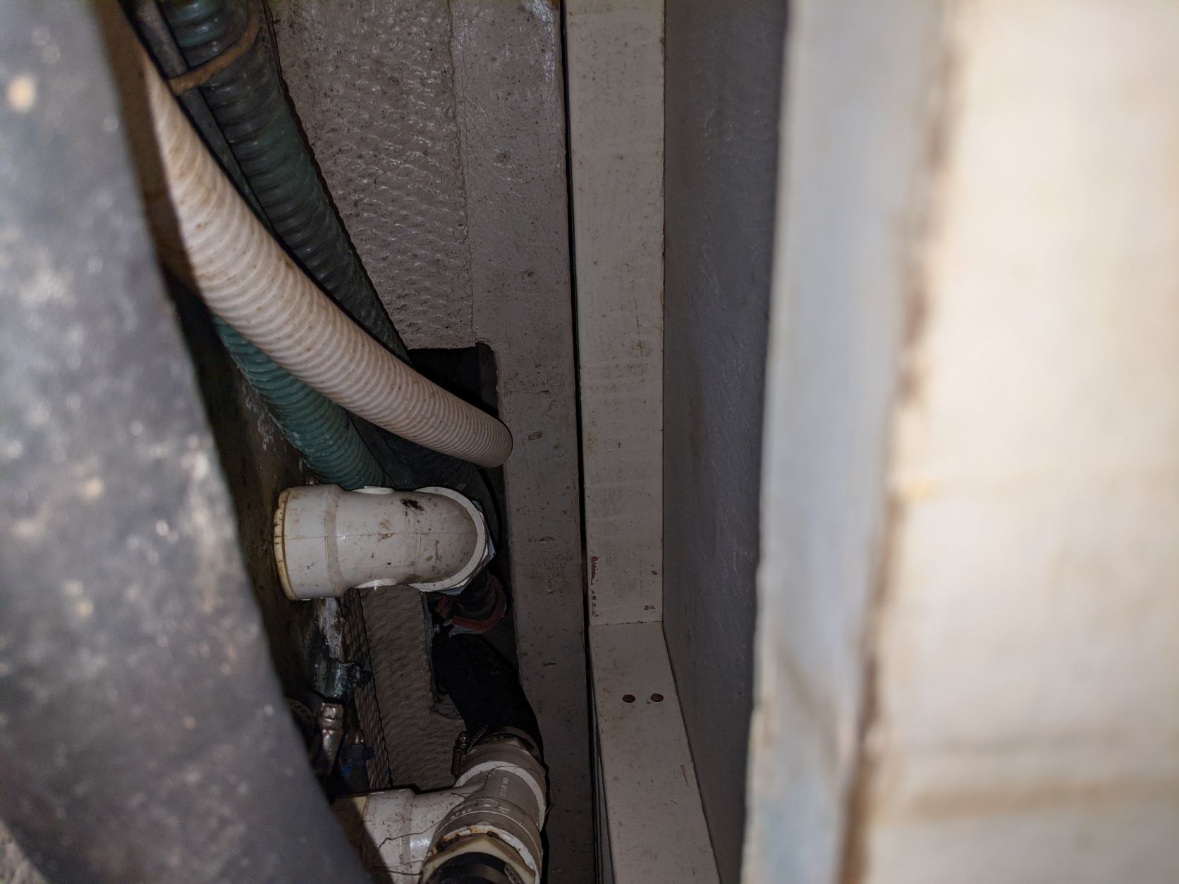

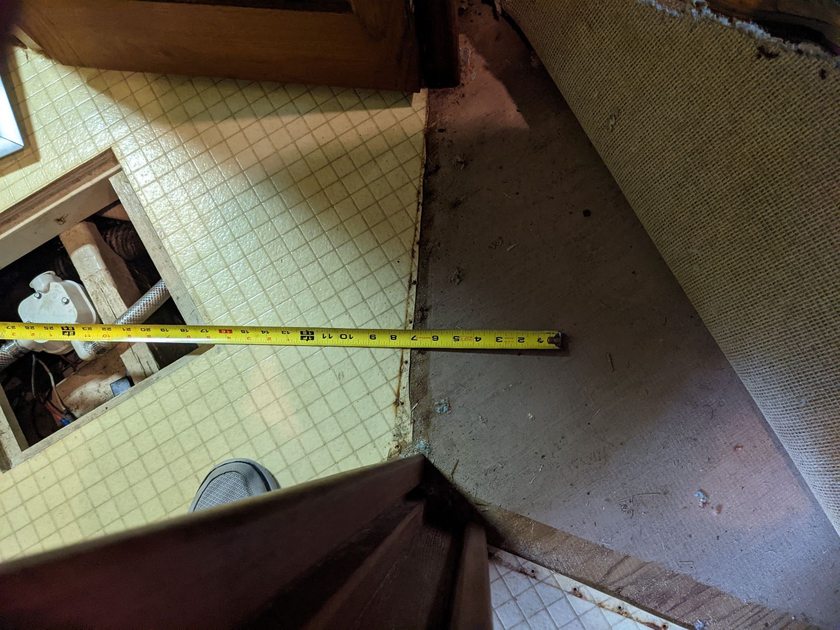

    Here are some pictures I took showing the connections, and the approximate location of the tee for the pump out and macerator connection (end of the tape) tank connections1.jpg tank connections1.jpg tank location1.jpg

    Appears to be the same as mine, another thought is to simply make the hatch bigger to allow access to the fitting.

    Thanks for the replies. I guess they are all a little different. The only hatch in my head is the one you see (yellow linoleum). My pump out and vent are behind a panel in the closet in the guest stateroom. The switch for the macerator is under the sink, but the macerator is in the master stateroom by the Y valve for the toilet outlet.
    The first picture is from the hatch in the head, looking forward and towards the centerline. The second picture shows when the Tee is under the floor. I measured from the hatch in the head, and from the hatch in the master and the end of the tape measure is the location of the Tee. You can see that there is no access hatch in that area.
