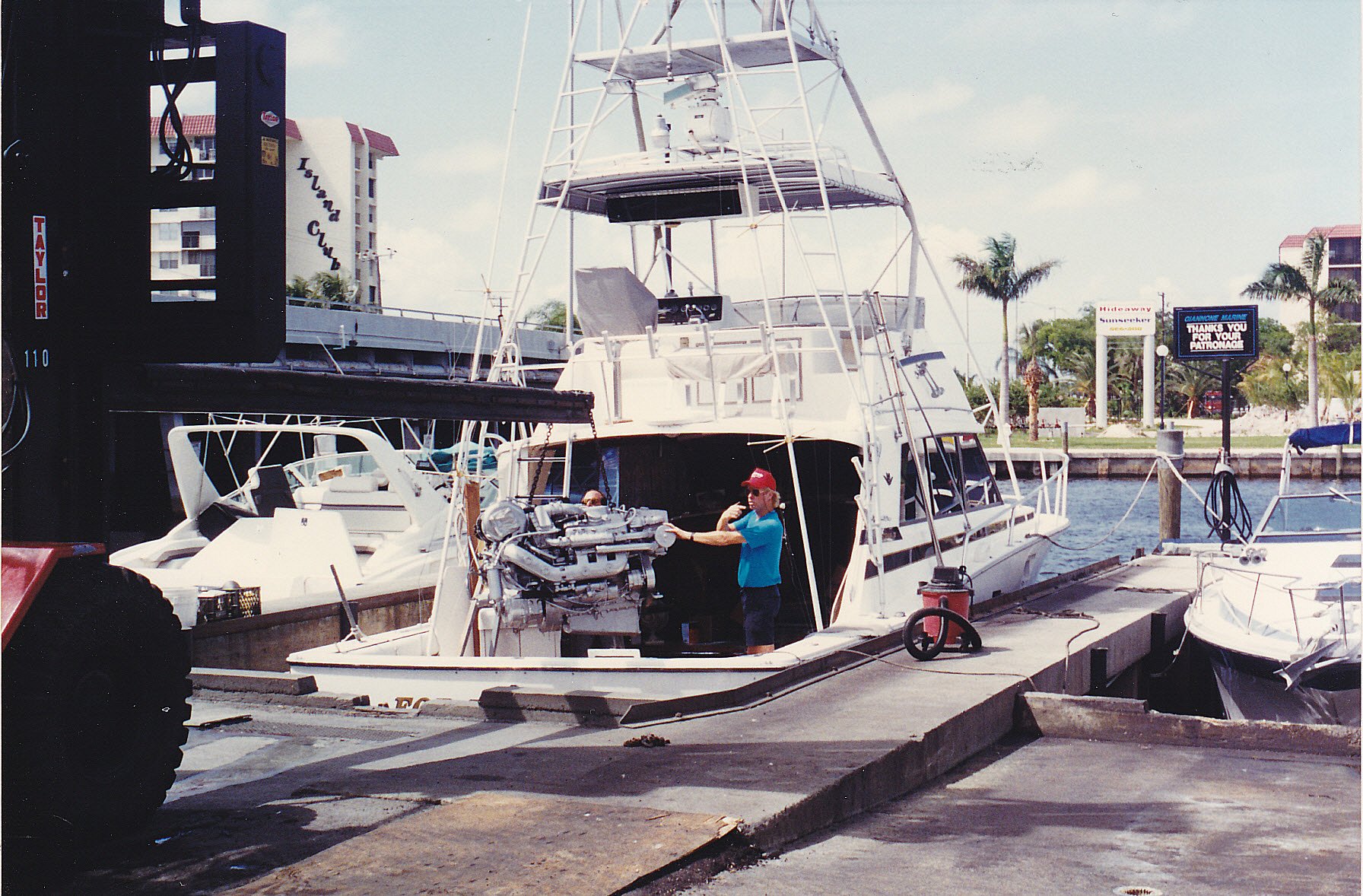

  20. SplashFl
    SplashFl Senior Member
    Feb 2, 2021
    698
    S. Florida _ Bertram 46
    When we repowered my previous 38 Bertram we also used angled transmissions and even with them the engines were right up to the salon floor. The only way to check heat exchanger water was via new cut-outs under the salon floor rug. There was an engine broker on St. Rd. 84 back then. I think he was affiliated with RPM Diesel.
