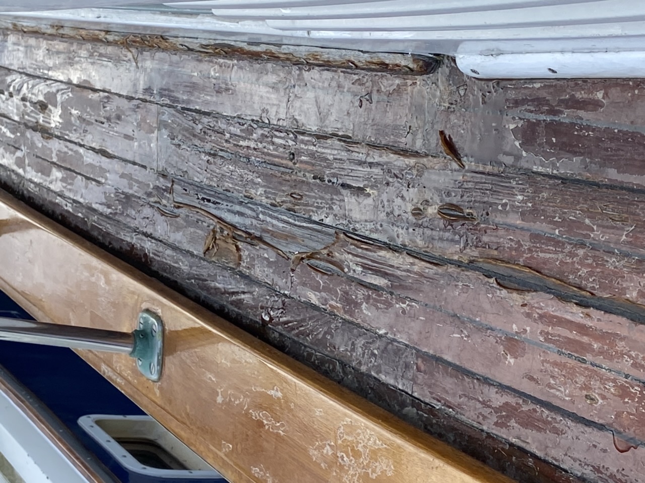

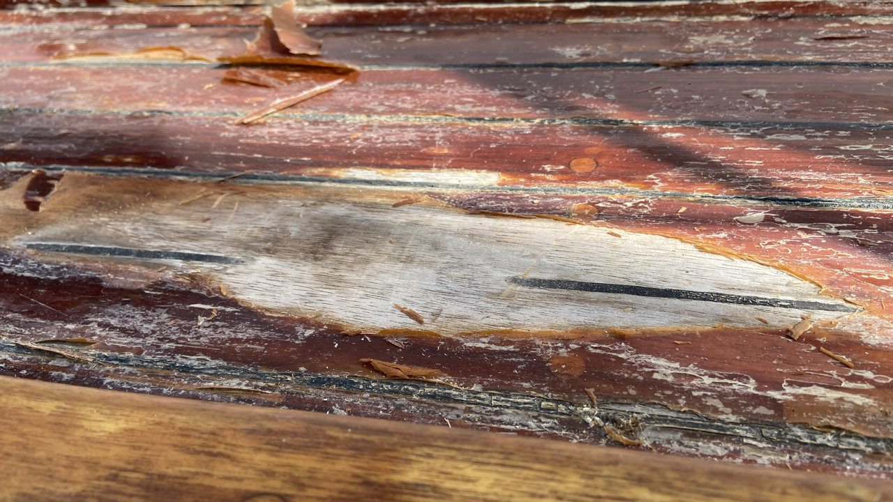

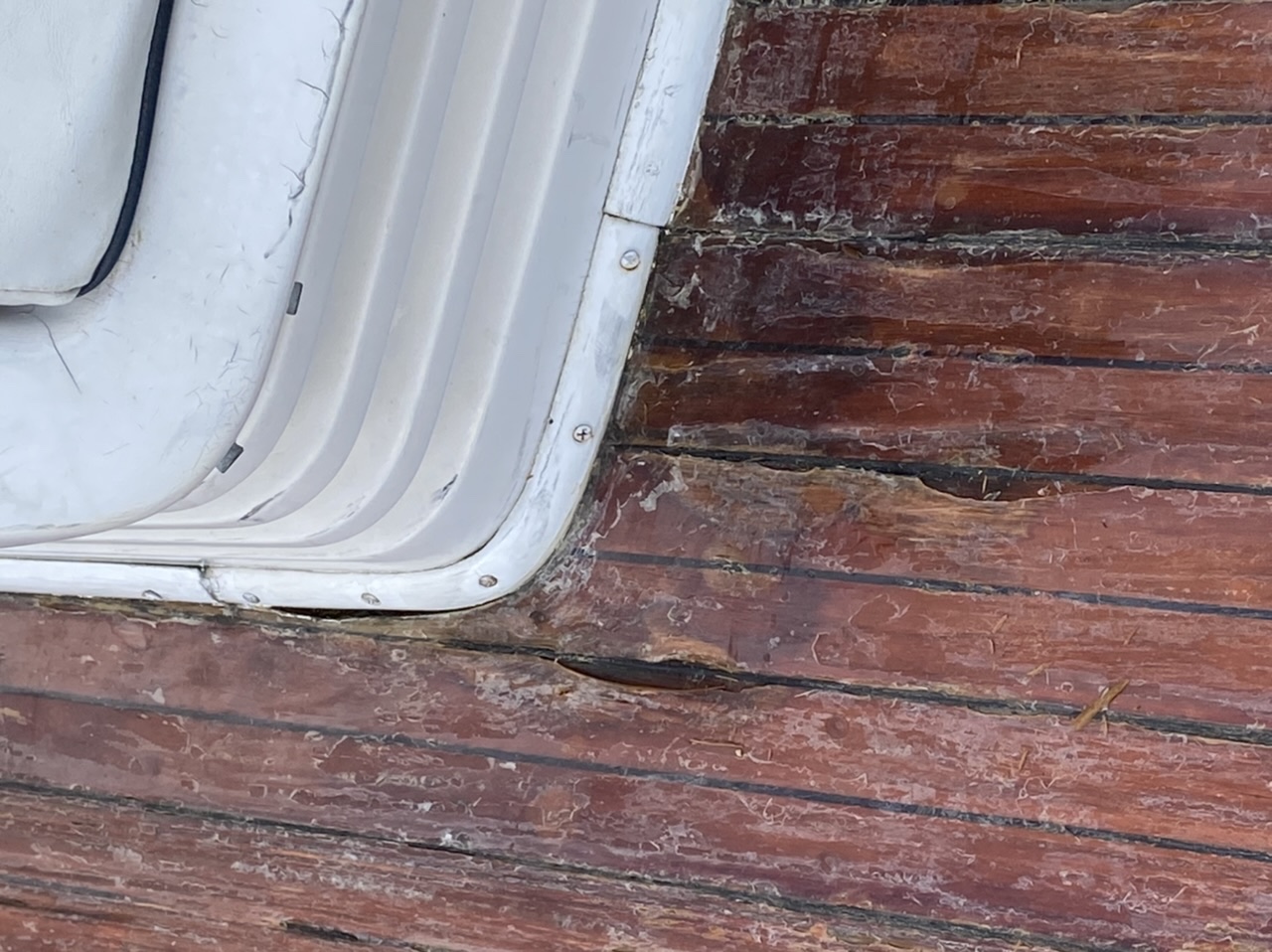

    New to this forum and boating in general. Recently purchased a 46’ wooden Chris Craft Constellation - Scorpio.
    overall in great shape so-it-seems
    She has had 3 owners, now us.
    my question is this…. The forward deck is what appears to be planked with 2”teak strips; however the sikaflex joints or lines are worn down to bare wood in places; leaving me to wonder if it is a form of plywood or perhaps wider than 2” planks. a previous owner applied heavy coats of varnish on all surfaces and it is blistered and rolling.
    my intention is to remove that coating and restore the best I can
    YouTube has only so much information and even that seems conflicted. 04EECDA6-1CC5-4076-AF3A-AA79976FB09A.jpeg 8F03E17B-FC96-419B-B168-F587147337FE.jpeg 0F47B264-5885-4900-A85B-62A56D512D4F.jpeg any way, if anyone has tips, tricks or advice. I am currently a sponge and just soaking up all the information I can get.
    thank you all,
    Marcus

    That teak is a thin veneer that is, I believe backed with plywood. The actual "planks" are 2 or 3 teak strips wide. If you're down through the black caulk, the deck is pretty much done. Take it up, new plywood, and fiberglass it. Then paint with non skid. It's a fairly big job.
  3. MBevins
    MBevins Senior Member
    May 23, 2008
    1,172
    Windsor On. Canada
    As SeaEric said. Unfortunately having someone replace that decking would probably cost more than the actual boat. Best look at fiberglass and nonskid.
