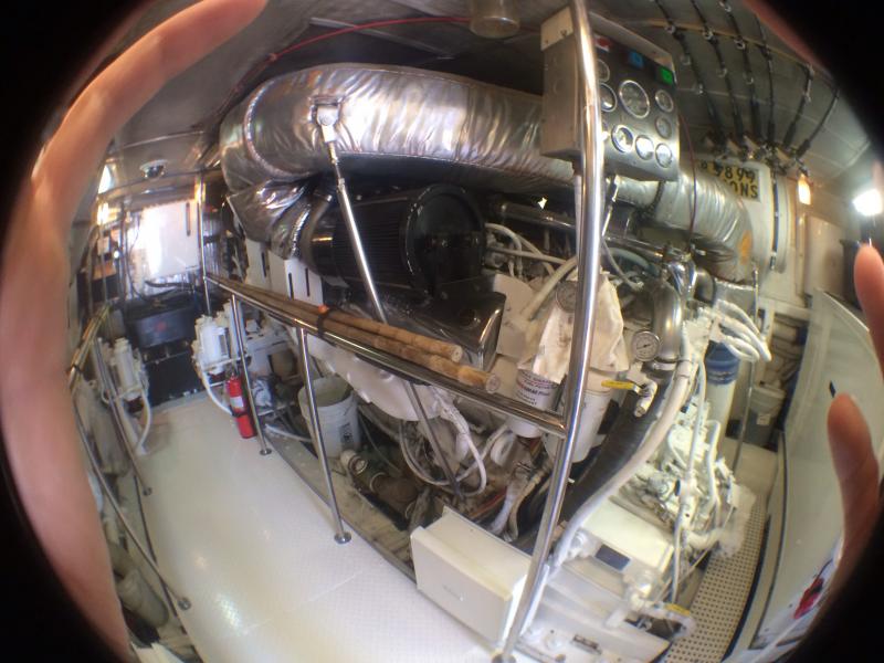

    Fun day at the show in Newport. Favorite boat was 82 hatteras w 16v149. They were just huge!
    Love to hear comments on these monsters. Also loved the reel display case

    Is that a old 2 stroke Detroit? V16, 149CI per jug?
  4. Capt Ralph
    13,427
    Yep
    My local shop used to rebuild those monsters in their shop. The hydraulic dyno (at that time) could not put a full load on the 16v149T (A or I, think A)
  5. 993RSR
    993RSR Senior Member
    Jan 15, 2004
    517
    Annapolis/ Palm Harbor
    I think they ended production around 1600HP each which means 100GPH PER ENGINE at cruise. Hope she carries huge tanks (and credit line ;-)

  8. Capt Ralph
    13,427
    You can Not idle around 149s. A real machine that was made to run. Generators that ran whole Towns, Dredges, Tugs. When it comes to commit pure torque to a shaft and near fly, the big 149s were here.
    That many horses are going to draw some fuel. Big Cats and others are going to draw fuel. If they run good with no maintenance issues, run em & run em proudly. The exhaust tone must be awesome.
    I would think they are ALMOST as much forgiving as a 71. No forgiveness in a strung 92.
    At 1600 hp each VS the other models, Maybe a lil more fuel. The weight pr HP stinks VS newer engine packages. But it's already there and reliable.
    3200 total HP is going to consume a bunch of fuel no matter who's what block you have down there.
    Now,,, Do you like the boat???
  9. Capt J
    14,524
    Not really. A 1650HP C32 acert burns 70 gph at 80% load
    a 2000hp 16v2000 burns 75GPH at 80%
    compared to 100 gph??? And both of the motors above would net a higher cruise speed as well.
  10. Capt Ralph
    13,427
    The 1800 bhp 16v149TIs (non DDEC) consume a bit over 90gph on the pins (EACH). 80% load would be lower to that and closer to your figures.
    Still not a mpg king VS newer models, but not that bad.
    Then double the numbers (twin installation) and that 100gph quote get blown away (under a good load). At 1550 rpm (Max 1900) the 149 maybe a touch underloaded but doing 50gph each (1450bhp).
    Anybody who can afford these burn rates is probably not a MPG bean counter anyway. Within a few local fishing trips they may burn more that I do all year. I think the 149s that are are out there are pretty dependable.
