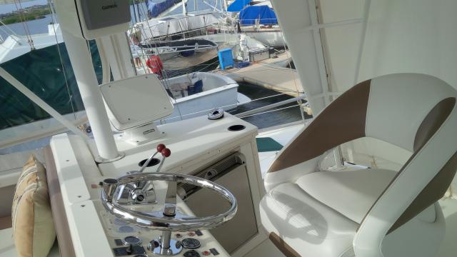

    Everything on my boat is 12v and 110v by inverter (5.000/10.000w). I have three 245w solar panels and 4 large 6v Trojan batteries, I run only the 3 aircons on my generator, all in all a bullet proof configuration in a sunny climate!
    Galley Fridge is SunDanzer 12 Volt Upright Combination Refrigerator and Freezer - DCRF134
    [​IMG]
    Flybridge Fridge/freezer is Norcold 12 Volt
