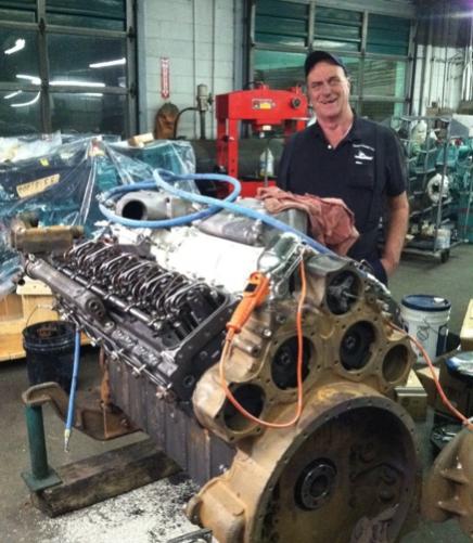

    Pull the engine and do it right. I was in your same position a few years ago and wasted $100k while two different scumbag shops wasted their time and my money. Ultimately, a true pro built the engine on the stand for $45k and put it in the boat. The interior comes out easier than you think and the entire built engine goes in through that rear window. I will NEVER EVER attempt an in hull overhaul again. All you need to do is remove the rear couch and pull up the carpet. That will expose the two 4x8 or so plywood panels that will expose each engine. You have the perfect boat to pull the engine so there is just no good excuse not to.
    PM me if you want the names of the scumbags.
    Here is a photo of the good guy. That's John Carey of Carey's Diesel, Leipsic, DE with my port side engine. He took it from basket case in the back of a box truck to built and installed in 30 days. What a nice guy and true professional.

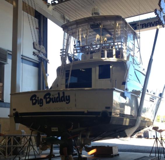

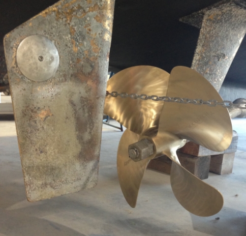

    Here are the fresh Michigan Wheel DQX Nibral 4 blade 28x27 Props
    In the slings at Front Street Shipyard, Belfast Maine after a quick week of work.
