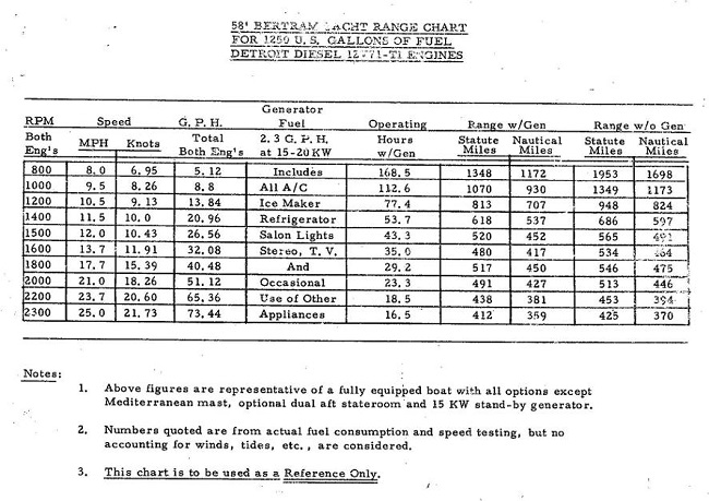

    Does anyone have a fuel burn chart or graph for the DD 12V71 Ti series engines installed in a late 80"s
    Viking 63 Motor yacht? Anything would be helpful Thanks

    PM me with your e-mail address and HP tune and I'll dive into my archives.

    I ran a 75' Hatteras with 12v71TI covingtons and I think they were 760 HP although cannot remember. We burned 12 gphs for the pair at 1000 rpms, 80gph for both at 1900.

    Hope well.. At the 12 at 80 gph what was your average mph for your 75 vessel ? Thanks,, edad
  6. Capt J
    14,432
    It was a 1987 65' Hatteras MY extended to 75. Heavy on fuel 16.5-17 knots. Lighter (1/2 fuel) and in the right location 19 knots at 1900 rpms. Held 1700 gallons of fuel.

    For the faint of heart, That is over 4.2 Gallons per mile.
    If your trying to find economy in a big boat traveling faster than idle; Go back to sleep,, only in our dreams. :)
    At 19 kts, were doing 3.5 gallons per mile, down hill, with the wind, with some imagination. :rolleyes:

    I have 1990 12V 71TI with turbos recently rebuilt with only a couple of hundred hours on them. I run them about 1200-1250 rpm. Slow I know so every once and awhile push them to 1800 to clean out the air boxes. However the last couple of thousand miles running both engines with 30KW generator I have been getting about 1-gallon per mile. I know most would tell you this is impossible, but with a total weight of 100K my hull allows the boat to run really nice and at 2300rmp we can do almost 30 knots. I wouldn't believe it myself if I had not experienced it. I have found that if you keep the hull clean, props and drive shaft tru, and fresh oil these engines will treat you right.

    Those engines burn about 80 GPH at 1900 rpms. At 1000 rpms they burn 12 gph for both, 1200 25 gph. You should really run them at high cruise for 30 minutes every 6 hours at most (1900 rpms+) for longevity. But would make more sense for you to run at 1000 rpms and then cruise for 30 minutes every 6 hours, for fuel burn and longevity.

    I'm running 12v71TI's now at around 750 HP each. I'm cruising at 1375, burning a combined 22 GPH at 10.5 knots with a generator running...
