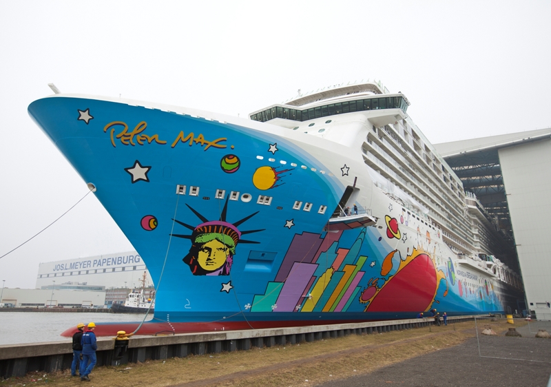

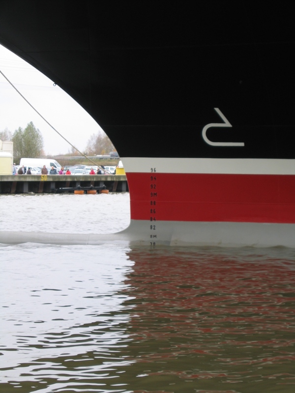

    Below some pictures I took in the Meyer Werft during prelaunches.
    Some precise maneuvering is mandated, in order to get those monsters out of the shed.
    This is picture of Disney Dreams bow just prior transfer down the river Ems towards the North Sea for sea trials. She still sits several meters obove her CWL. The final outfitting with lose items and optionals has to be done in a harbour at the coast. The river is not deep enough for full displacement.
    I have been onboard Disney Dream during one sea trial campaign with the boat still under yard flag. The classification authority ordered hard rudder at full throttle and speed. The yard captain warned all people onboard prior starting the maneuver. But nothing really happened. A little heel and a pretty quick 180 degree turn, thats all. A pretty stable ship.
    By looking at those monsters with this number of decks above the waterline, one might think, they must be unstable. But the biggest weight is below the waterline and the stability and righting moment mandated by class has sufficient margin for some human errors.

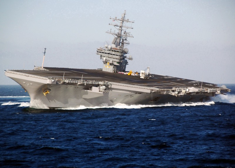

    One more nice example of operator induced heel. Much more speed, highly maneuverable ship and really top heavy.
    And even that is by no means dangerous. Also flying operations might be a little bit hampered at that amount of heel :D. I have only landed with a helicopter (as a passenger !) on a carrier, the USS Nimitz. But I think, Your Navy is still doing fixed wing flying operations with their floating airfields rocking like that.

    Given that my background does not include working with NAVAIR or NAVSEA, but does include operating with the bird-farms, I can say this about that.
    No aircraft are operated from a carrier when conducting a high speed turn as depicted in the picture.
    The carriers will steam into the wind to launch and recover. Note to the arm chair admirals. Since the angle-deck of the carrier is approximately 15 degrees off-center, the ship would adjust course accordingly.
    And for the sea trials that the ship was conducting, those vehicles on the deck were securely chained down!!
    As for "really top heavy"? Given the amount of machinery below decks, and the fuel for aircraft, and the ordanance stowed deep in the hull, and given the thickness of the underbody, the ship is not top heavy.

    I know that carriers are steaming straight into the wind during t/o and landing operation. I was a military jet pilot in the German Navy and later in the German Air Force in my "first life" before my family called me and my family loyalty into our family shipping business. I was just talking about the ships "rocking" in rough sea. And with top heavy I only ment it looks top heavy. Sorry for my humble and limited written english.
