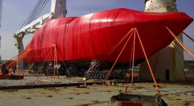

    Shrink wrapping is always a good idea for any non containerized deck load. It protects not only from soot and salt. It protects from water ingress and minor damage on delicate appendages, when the cargo vessel passes trough rough seas and this especially on yachts. Last but not least, according to insurance statistics, shrink wrapped yachts carried as deckload are far less affected by thievery of electronics, entertainment equipment and other loose interior of value. As far as I know, depending on the insurance company, shrink wrapping will lower the insurance rate for a deck load, both for damage and thievery.
    Depending on the schedule, the route of the cargo vessel and its intermediate ports of call, I would highly recommend a shrink wrapping of a newer yacht of this size.
    Better wrapped than sorry, old Chinese saying :).

    I am one of only 2 Captains that the shipping company he is using, uses for all of their loadings and unloadings. If you're shipping it from the MED to West Coast of U.S., it ships on 1 ship to Palm Beach, then goes on the 2nd ship to the West Coast, I or Chris unload it, take it to a marina, and then load it on the next ship that goes. I do somewhere in the neighborhood of 75 yacht loadings/unloadings of yachts per year for this company and have been for over a decade. I used to do almost all of Yachtpaths at various points in time as well. I've loaded as large as a 148' MY, and recently ran Drumfire which unloaded 2 weeks ago, which looked as clean as if you just washed it. I've loaded yachts on 3 different companies freighters in 1 day before, I've loaded or unloaded as many as 7 in 1 day, and many times 2+ yachts in a day. This is one of my specialties.
    Very few of the yachts that I have loaded or unloaded have been shrink wrapped. Less than 1 out of 40. Of all of the yachts I can remember, only 1 was dirty with soot and nothing that a good washdown would not remove. About 2% of those have little specs of rust on the side walkways the size of a grain of cracked black pepper from grinding the deck welds. Whink would easily remove them with no scrubbing. A few of them have come over with salt encrusted on them, a very small percentage and usually in the winter when it's rough. But generally, 98% of them come over pretty darn clean.
    Now, if the OP was shipping it from the Med to Tokyo, or from the U.S. to Guam, on a ship that was making multiple stops and loading/unloading multiple cargo in different ports and a much longer voyage, I'd recommend shrink wrapping it. But not on this one that is 12-14 days of seatime in a good weather part of the year. And whoever shrink wrapped the boat with the red shrink wrap should be shot. The shrink wrapping is so loose, you're going to get a lot of abrasion between the wrap and gelcoat/paint, it should be tight and the wrap shouldn't move.

    That is called wrap polishing Capt J :). And I promise, it is not my cargo Ship. We do not work for Sunseeker.
    But I do agree on your last paragraph. That why I said : Depending on the schedule, the route of the cargo vessel and its intermediate ports of call...... But I feel the rest of my post is still valid. And a yacht does not need to be completely wrapped. Sometimes only the window part of the superstructure and maybe the flybridge is wrapped.
