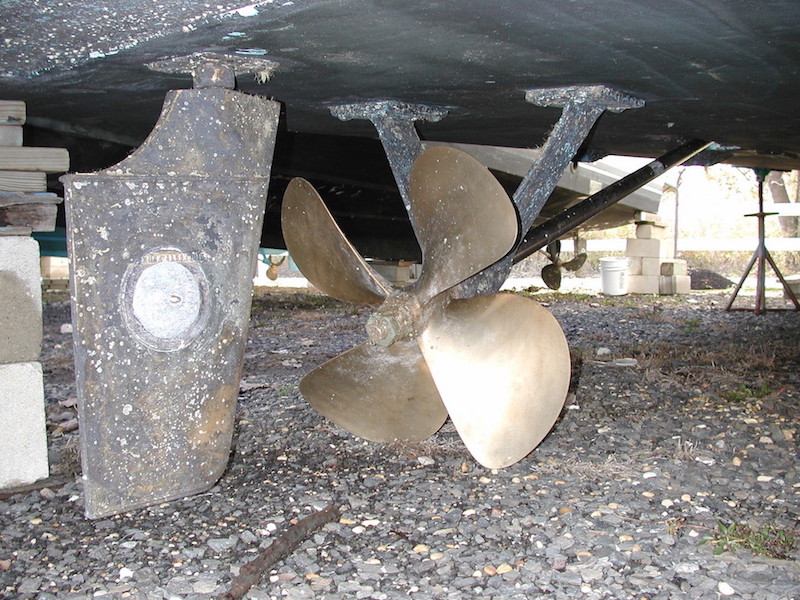

    Did anybody upgrade from the old Rudder know if it's worth it doing I have old rudders on my 83 post is it worth upgrading spending the money on the new ones doesn't make a big difference

    I did mine. But I was forced to when one rudder spun on the post.
    I ended redoing everything for the steering. Rudders, ports, the shelf etc.
    The replacement rudders were a different shape and a bit wedge shaped.
    I was also told, by Post, that the newer style rudder would be better for steering. But I do not recall if there was any difference.

    That's the new style I was just curious if there was any difference in the ride that's definitely the new style I was thinking about doing that new style but I just wanted to talk to somebody and be sure it's worth my you no money to buy the newer ones they say it makes a big difference some people have told me but I don't know anybody that's made the switch

    I really don't recall. But, considering the amount of money and time spent, I'm sure I convinced myself at the time it was an improvement.
    I know a lot of people criticize the older Posts' ride in a following sea, but with only 4 degrees of deadrise you have to expect that somewhat.
    I could see where the blade being deeper and less length horizontally how it would be better in certain sea conditions, e.g. following sea pushing all that surface area of the original rudders.

    It looks like I did the work in 2002 for about $1700, not including the rudder shelf I made out of fiberglass.

    I only did the rudders because one of the originals spun on the shaft.
    I don't recall the exact makeup, it was either:
    Bronze rudder, stainless pin, bronze shaft
    or
    Bronze rudder, stainless pin, stainless shaft
    That coupled with a neighbors leaky boat equal a failed rudder (electrical - galvanic corrosion).
    The shaft had a shaped end cast into the rudder. Either the shaft deformed or the rudder.
    Was an expensive year for me.
    Rudders and all the hardware
    Shafts and dripless couplings
    Props
