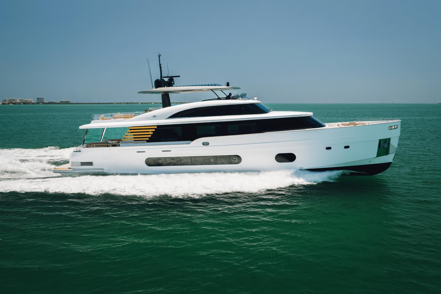

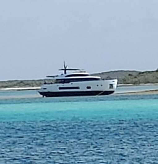

  17. Pascal
    8,716
    Not my picture, this was taken about 20 miles south at Farmers. Going to take a while to get this one off.
    don’t know the name, any idea what kind of boat that is?
  18. Norseman
    Norseman Senior Member
    Feb 24, 2005
    3,296
    Palm Coast, Florida
    82 Azimut perhaps?
  19. Pascal
    8,716
    Definitely! Thanks. I was wondering
